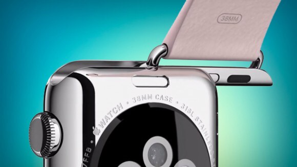

    During my try on appointment, the guy that was helping me try on the SS models brought up an excellent point that I have not seen discussed on the forums yet. (Trust me, I've been reading these forums for every launch and very closely for this watch as I have ordered a SS w/ Blk Sport Band, 12:03 ~ 4/24-5/8)
    The person next to me was trying on the sport watch with the milanese loop and the guy said that since the attachment for the loop is stainless steel, this and every other band with stainless steel or metal attachment, will eventually wear out the aluminum opening after you slide it on and off so many times.
    This doesn't really affect me in any way since I ordered the SS, but if this is true, which it logically makes sense to me, this should be kept in mind for all those people using the click adapter, link bracelet, classic buckle, milanese loop, or modern buckle with their sport watches.

    No. You'd wear out the clicky-button lock mechanism long before that. Alu alloy is quite resistant to casual wear; there are no large forces involved here, so it will last essentially forever pretty much. Well, certainly much much much longer than the electronic components inside the watch itself anyway.
    Of course, you'd scuff and eventually wear off the surface anodizing around the band attachment points (especially with store demonstration models, since people tend to be pretty careless with things they don't own themselves :rolleyes:), but not the metal itself. You probably want to be careful when exchanging bands on space grey models for this reason.

    If you've been in and looked at the bands there are nylon inserts on the sliders so it's not metal to metal contact.

    I think the rep may have been referring to galvanic corrosion in which the aluminium would corrode when in contact with the steel, but only if there's a passing electric charge. I've only done a few minutes research on this, so I may be missing some finer details.

    This has been addressed, though I can't find the link now and I'm not going to go digging for it. The pieces that come in contact are coated so galvanic corrosion is a non-issue.
