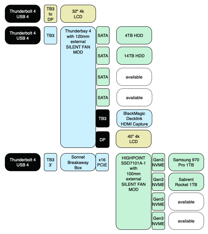

Coming from a MacPro 5,1 and a high end hackintosh, I had a pre-existing NVME interface and SSDs as well as HDDs to accomodate for the mac studio with external enclosures. Since external enclosures generally introduce noise to the environment, I was able to mitigate 90% of the the Thunderbay's fan noise and 100% of the SSD7101A's fan noise with the creative use of larger, lower RPM fans. I can follow up with pics of the modifications of there is interest.

handheldgames
macrumors 68000
Apr 4, 2009
1,938
1,168
Pacific NW, USA
I'd be interested in your fan mods. I have the Thunderbay 4, which is the only thing I hear with my Studio setup.
1st attempt: I removed the rear fan panel and used double sided foam tape to attach a 120MM fan rated at 21.5 DB. to the back of the Thunderbay 4. The fan was silent but Airflow through the chassis was excessive.
2nd attempt: I ordered a Noctua NA-SRC7 low noise adapter cable and after several tries, some good light and my reading glasses, I managed to attach it inline to the Thunderbay 4s internal mount. With that, noise dropped off the radar. Of note, temps of the hard disk increased be several degrees.
Lessons learned, Thunderbay 4 noise is not just the fan, it's airflow through the chassis. While the existing 92mm fan, when reduced in speed, may eliminate the noise, I'll go for the bigger the fan, with lower RPM's every time. I'll post a pic when I can.
