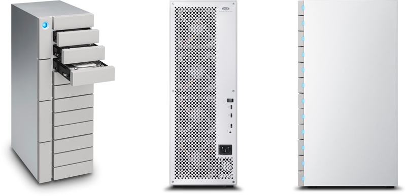

    I know you say consumer but really, I think vendors will come out with SSD based solutions soon for cheap.
    LaCie Big 12 2600 MB/s plus 2 4k screens or a single 5k screen can saturate the bus today.
    [​IMG]
