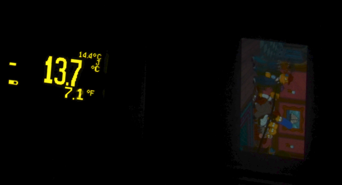

    Have a calibrated thermocouple affixed to the display of my IP4, currently reading -9C, and it's still playing...
    Now at -10C, and it's survived an episode of the Simpsons... going to let it lock, to see how much colder it'll get now that it's not generating much heat...

    Ok, I'd play longer, but I need to get some sleep tonight.
    Got to -14.1C when it went asleep, I woke it, and played another movie - it's working just fine. The LCD is getting a *tiny bit* sluggish, it's hardly perceptible compared to other displays I've see in the cold. That said, works just fine.
    Here be the proof. (iphone outside window - hence the "fuzzy" around the display)
    Edit: Final update - 1 hour at those temps, and it's still kicking. I wouldn't start to worry about the temps until it got well beyond -30C.
