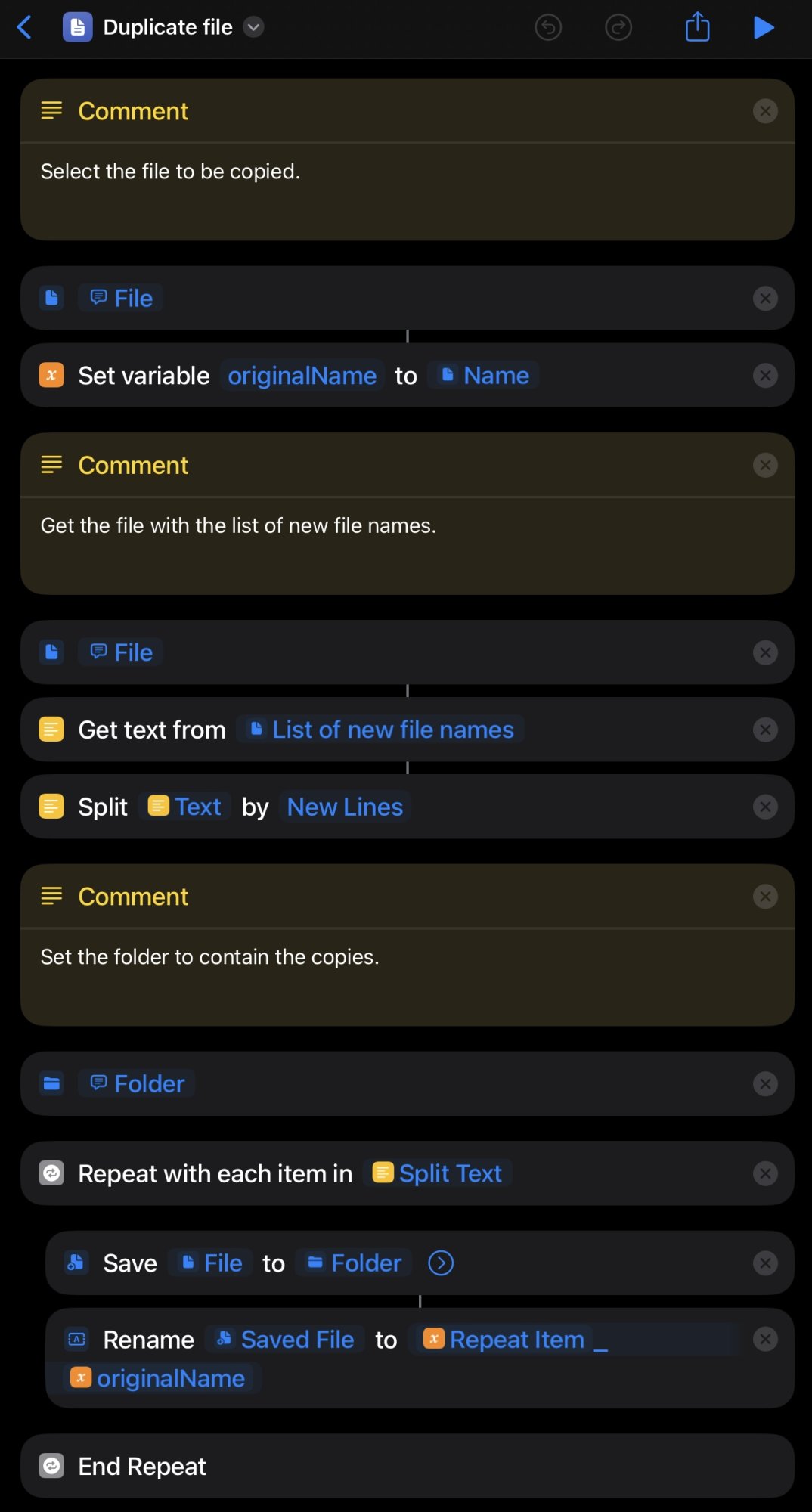

How are the duplicates transferred from the Mac to the iPad?
I asked, because I do not have any problems to copy all duplicates of a single file from a macOS-shared folder or via iCloud to an iPad using Apple‘s Files or Filebrowser Pro.
If you run into problems copying the duplicates from the Mac to the iPad, and if it just that you want to keep several copies/duplicates of the same file for whatever reasons on your iPad, why not just use Apple‘s Shortcuts and create the wanted number of duplicates on the iPad?
E.g.:
Thanks for the screenshot. I don't think this will solve the problem in question (or I'm misunderstanding), but I'll look into it.
I did however manage to resolve the problem this time around (by saving multiple instances of the PDF files in question instead of merely copying it), but it might get trickier if next time I want to transfer multiple copies of a file I can't edit or re-create.
