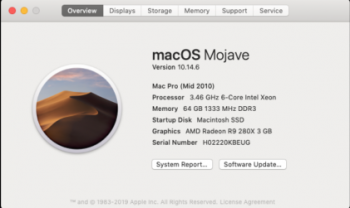

And, another twist. A seller on eBay has the same Mac Pro processor tray that I have, only with 64GB (16x4). The "About This Mac" window shows 64GB. If it recognizes 64GB, is it not using it? How is that possible?
No plot twist, it's just W36xx versus X56xx Xeons. Read the Mac Pro CPU Compatibility List.
