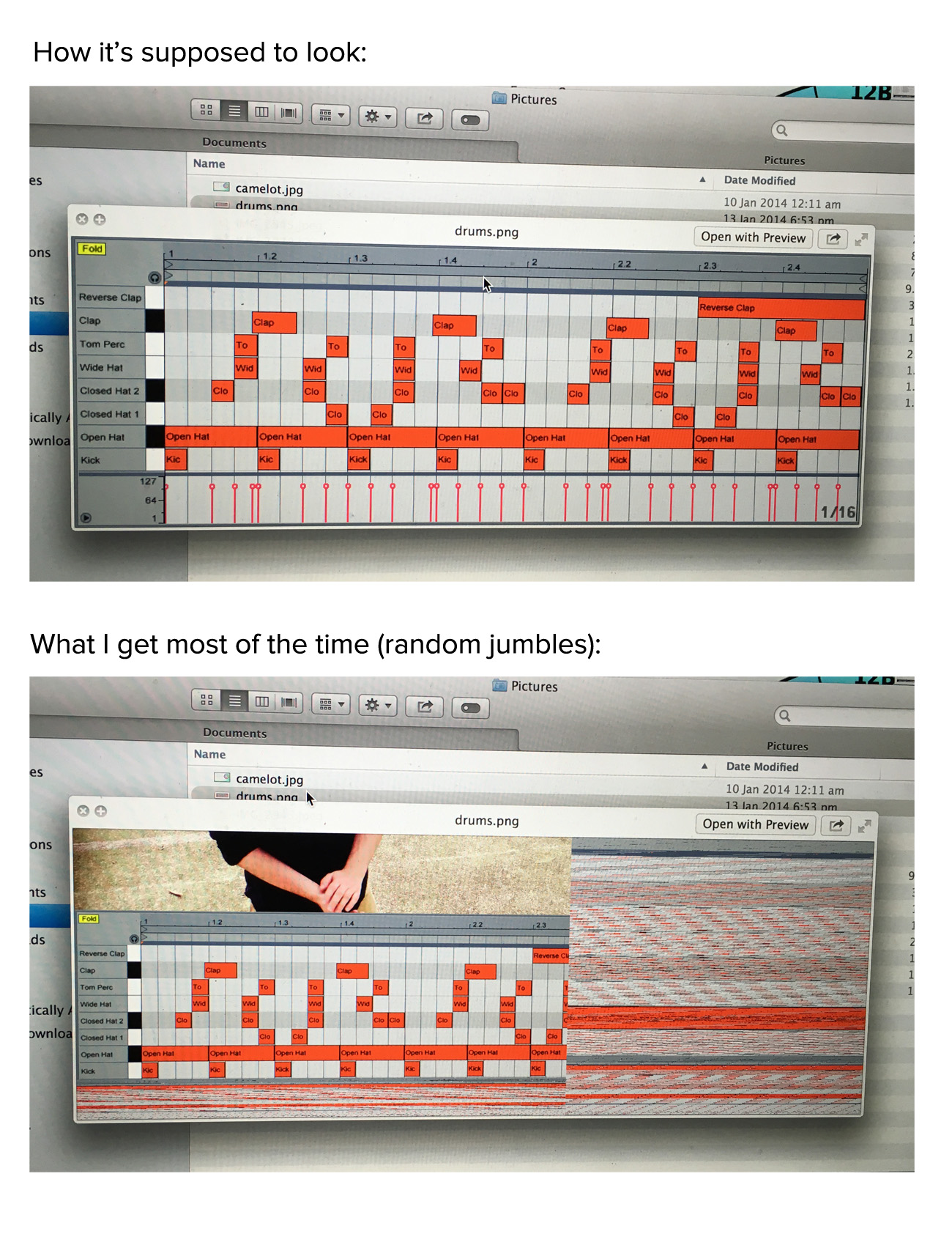

    Safe mode works fine, but GFX are quirky....

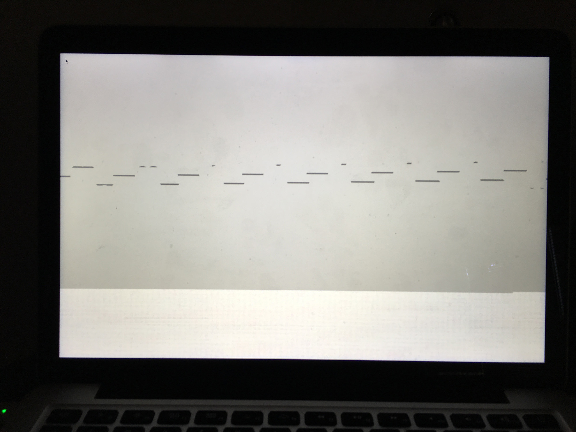

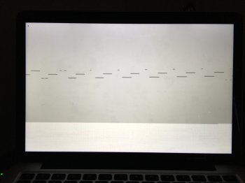

    What's funny though is that if I boot into safe mode, I can use the machine no problems. However, I did notice some little quirks in safe mode in regards to the graphics. Everything is a bit laggy and jittery, and I'm experiencing the zigzag line jitters in a few places: (1st pic in safe mode with Preview app, 2nd pic is after entering login details in standard boot):
    Is this a telltale sign of a failing graphics card or could this also be a logic board issue? Would a failing graphics card really make the audio in my DJ software skip/hang and freeze up the trackpad? I have a genius bar appointment in 2 days, any advice/help would be great before then! Thanks <3

    The GPU is built into the CPU which is soldered on to the logic board. Regardless of which part is bad, you're most likely going to need a new logic board.

    Apple's issues with GPUs is with discrete GPUs not integrated GPUs. The iGPU is part of the same silicon as the CPU, so it may not be going bad like radeongate. Nonetheless something funky is occurring and I recommend taking it into Apple. It does seem hardware related.

    As the others say the GPU is integrated on that machine, so it will be considered a logic board failure and they'll just replace the whole thing.
