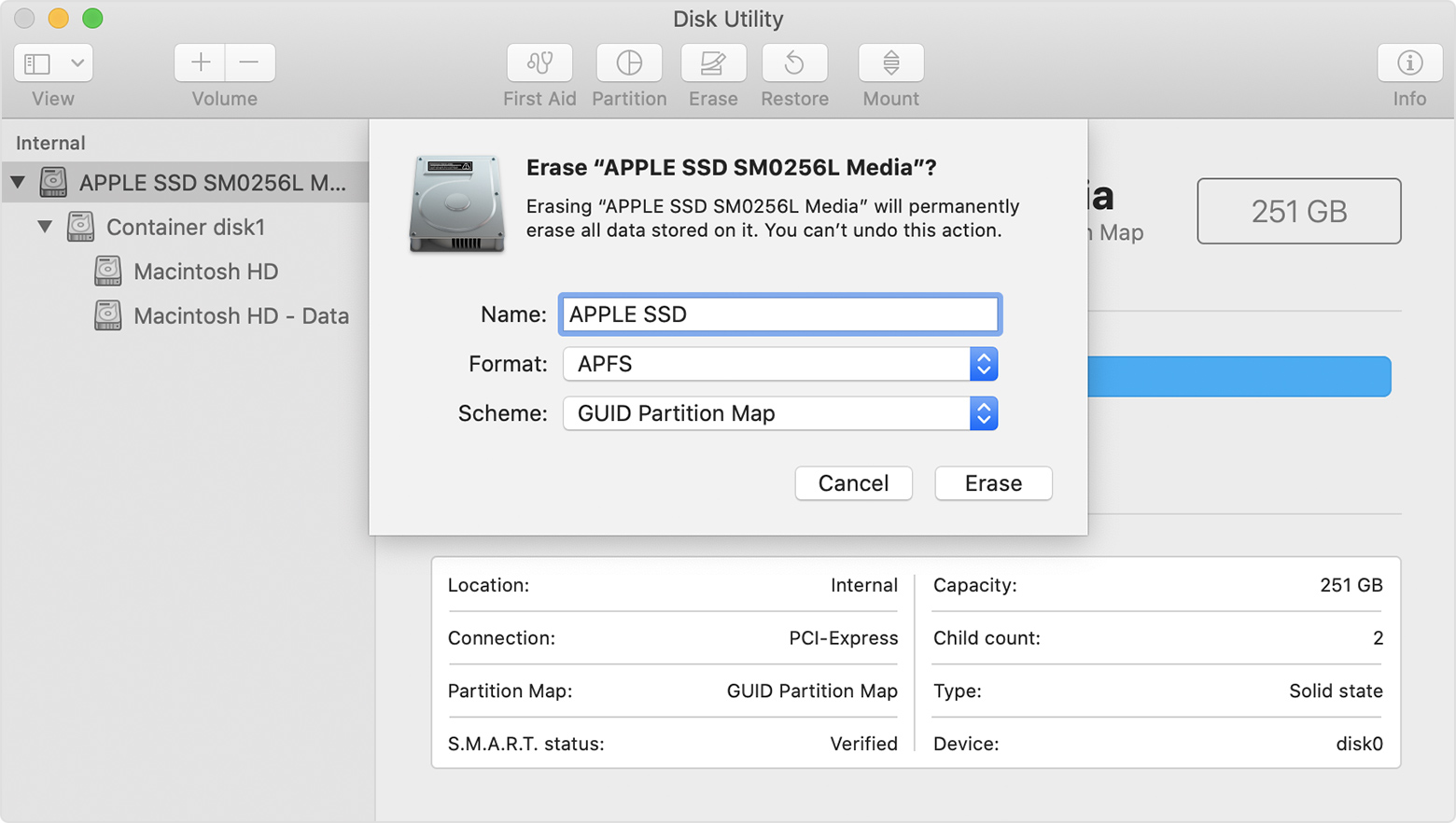

when I go to Disk Utility -> side bar -> under APPLE SSD -> Container disk2?? shouldn't be Container disk1?
https://support.apple.com/en-us/HT208496 has "Container disk1", how did I get "Container disk2", is this a minor bug with my Catalina? How do I fix this? Thanks in advance.
[automerge]1592173459[/automerge]
Also, in the white-colored box in the pic that I got from support.apple.com "Device: disk0", but for me I think it's "Device: disk1" or "Device: disk2". Is this a problem?

The SSD is disk0, which means that the first container would usually be assigned disk1.
If the SSD is assigned disk1, then the first container would be assigned disk2.
The numbering doesn't mean much to most users, as the system assigns those numbers without any input from the user.
You don't have any control over what the system (and the Unix-y disk tools) uses to number the various disks, containers and partitions.
Well, maybe you can change the disk numbers through some arcane terminal command, but not something that would be worth doing.
On your Mac, likely the disk0 was already used, maybe on the initial install.
Not something that you need to "fix", nor is it a "thing" that will affect anything. It's just internal numbering that your system uses to keep track of the various active drives and partitions.
