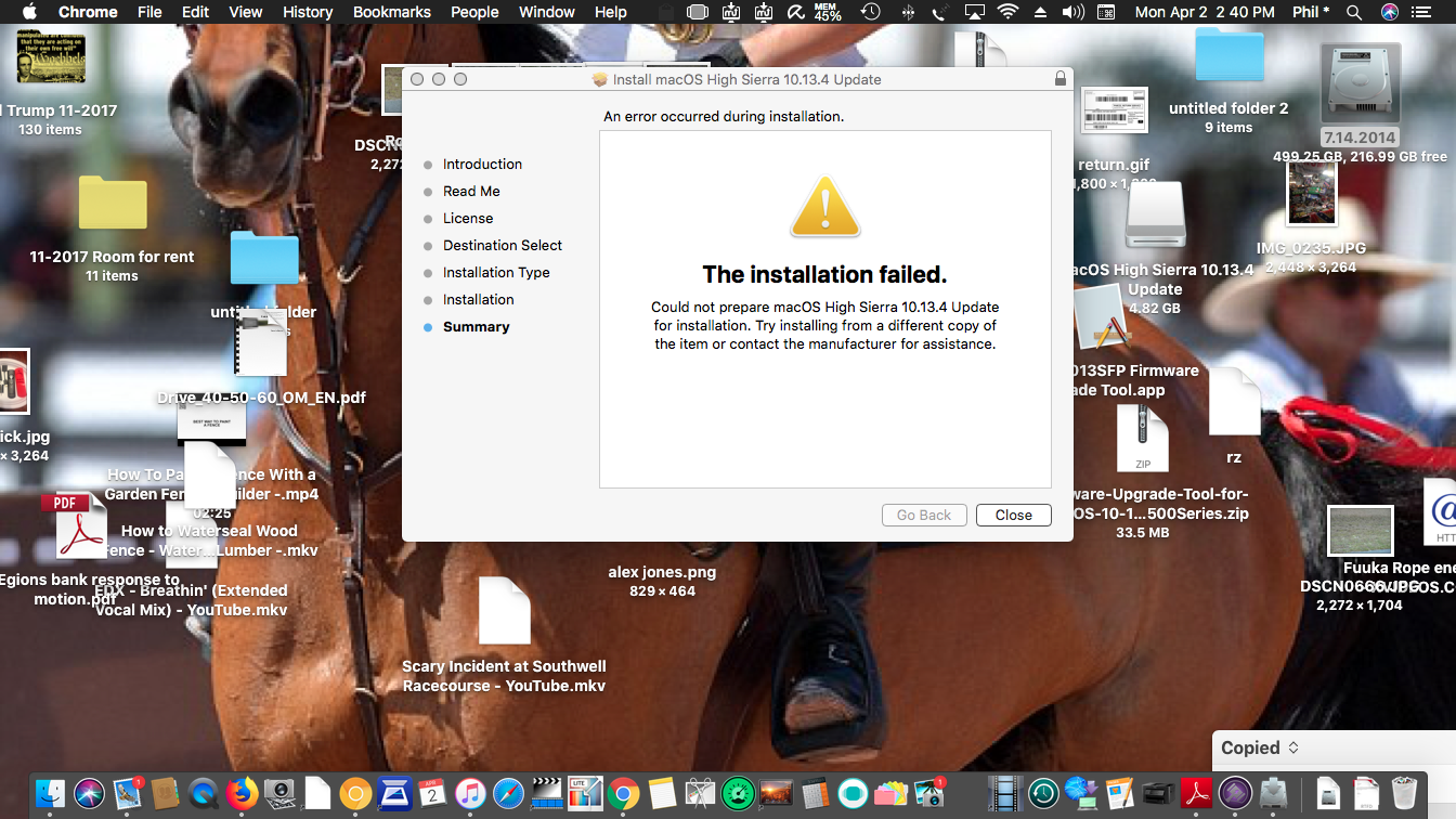

Did you try restarting your Mac immediately before you ran that updater app?
Be sure to try the combo updater. That install might be successful.
If not, you may be having some kind of problem with the system that you presently have installed, maybe some critical file has become corrupted somehow.
Download the full install. Use that to create a USB installer. Boot to that installer, and reinstall macOS. Hopefully, you won't need to get that far, but it's also a good plan to have a USB flash drive with the full installer, just in case you need that for some other purpose...
