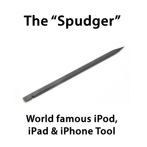

    Isn't a spudger metallic too?
  15. DeltaMac macrumors 604
    DeltaMac
    Joined:
    Jul 30, 2003
    Location:
    Delaware
    #16
    No, this is a spudger....

  17. DeltaMac macrumors 604
    DeltaMac
    Joined:
    Jul 30, 2003
    Location:
    Delaware
    #18
    Nope
    The nylon material appears almost shiny, but that's just from the lighting in the ifixit pictures. Not in any way metallic.
  18. bibyfok macrumors 6502
    bibyfok
    Joined:
    Jun 14, 2012
    Location:
    France
    #19
    Yeah, I got some of them and they are in nylon but looks a bit like metal.
