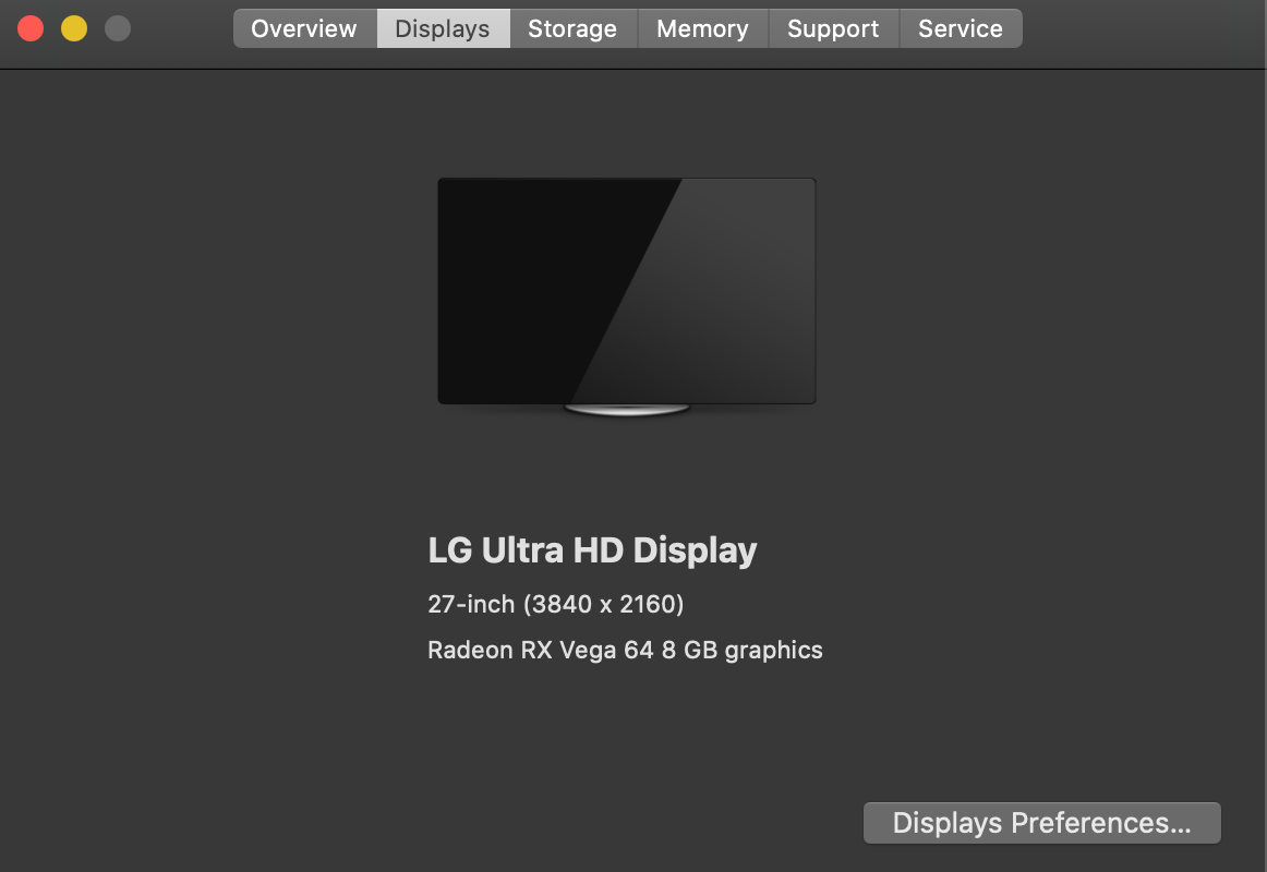

I have Same Monitor LG 32UD59-B 4K & LG 32UD60 but I have Something strange, I believe it's with these two models or maybe all of LG monitors, I have been tested "Dell" monitors and "view sonic" and "BenQ" they didn't have this issue. I will explain with a Picture took it from my system "macOS Catalina":-
LG 32'' showing 27" on system profile. same result when I connected with Real mac mini 2018 (UHD 630) & Hackintosh iMac & Hackintosh iMac Pro.
I don't have a Macbook pro to test it.
This for sure has an effect on the scales and apple logo size when mac system loading.
did anybody notice that? did anybody have an explanation for that?
and by the way, I have connected with sapphire Vega 64.

I have Same Monitor LG 32UD59-B 4K & LG 32UD60 but I have Something strange, I believe its with these two models or maybe all of LG monitors, I have been tested "Dell" monitors and "view sonic" and "BenQ" the didn't have this Issue. I will explained with a Picture took it from my system "MacOS Catalina" :-
LG 32'' showing 27" on system profile . same result when I connected with Real mac mini & Hackintosh iMac & Hackintosh iMac Pro.
I don't have Macbook pro to test it.
This for sure has effect on the scales and apple logo size when mac system loading.
did anybody notice that ? did anybody has explanation for that ?
My LG 24" also shows as a 27". macOS does not scale itself according to screen size so there's no difference in functionality. Only screen resolution is relevant to the operating system.
that really strange so its only with LG monitor then. because as I said before I have tested other manufacturer like dell 28" 4k, BenQ 32'' and Viewsonic 32'' they show right scales and right size monitors 28,32 and 31.9 as I remembered
