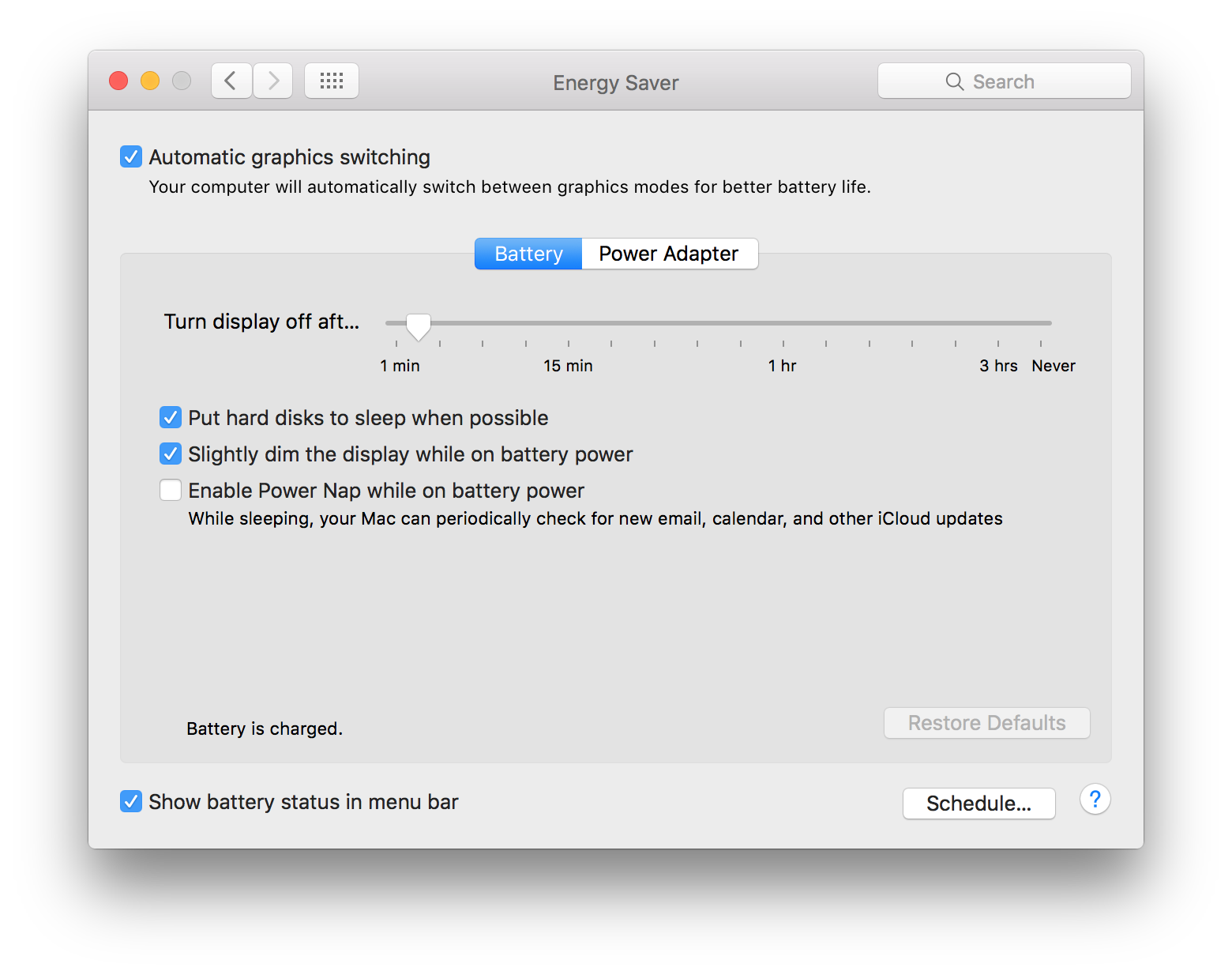

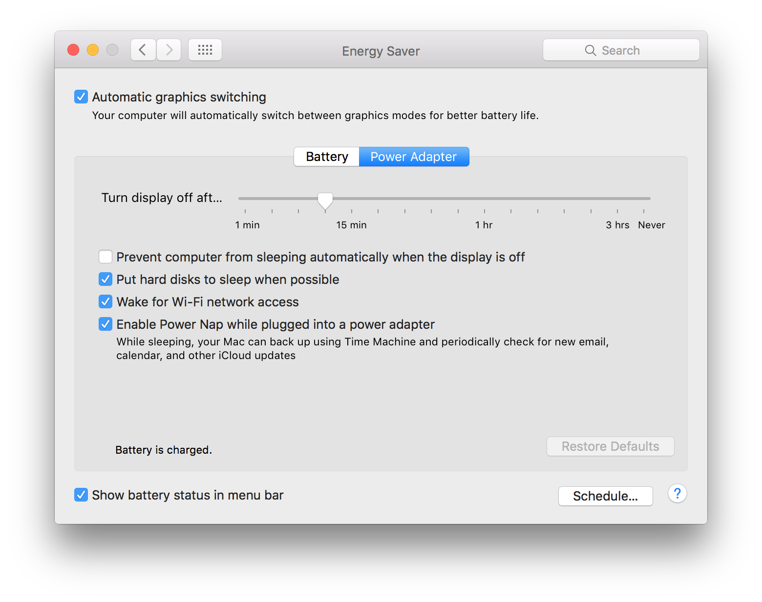

Yes, both Macs have clean installs of El Capitan. And both Macs had the same issue in Yosemite out of the box.
By the way, these are Mac's default Energy Saver settings:
