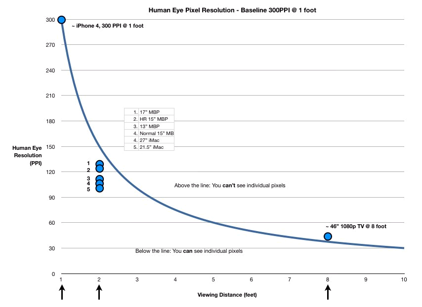

    The easiest way to remember is that "retina" uses the same calculation used to define "print quality" as being 300 DPI on a sheet of paper held one foot away.
    At 290PPI, you'd only have to hold it a little under 12-1/2 inches away to be "retina".
    A while back someone here created a chart to make it a bit easier, at least for larger distances:
