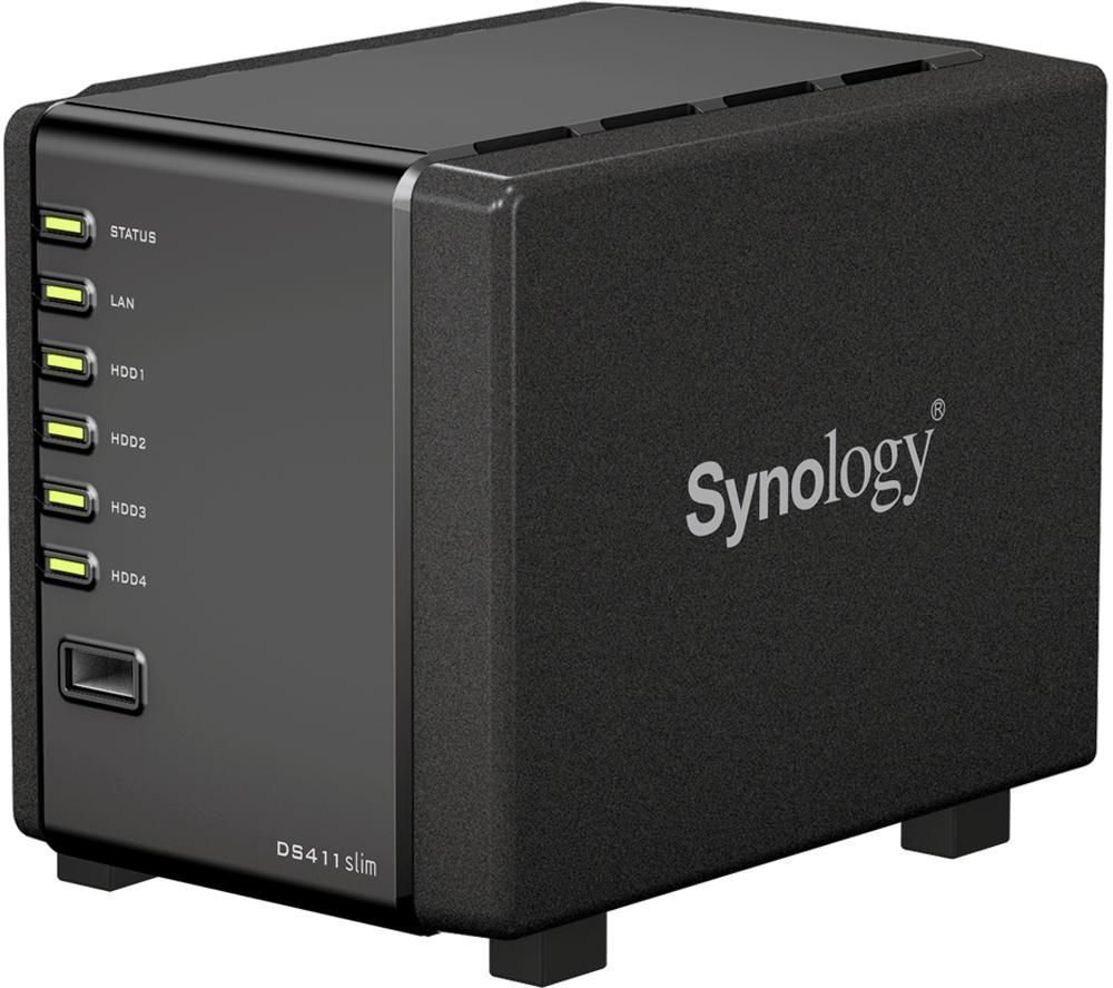

Now, who has recommendations for an insanely cheap (perhaps empty) 4-bay NAS? Anyone know if the Mediasonic HF2-SU3S2 is any good? It's pretty cheap.
Thats not a nas.
This is a nas
This is also a nas.

Thats not a nas.
This is a nas
Holy jeebies that pic is huge. Anyway, you are right. It lacks ethernet/Wi-Fi and doesn't look like it supports any RAID configurations, which is probably why it's so cheap. It's just a 4-bay enclosure.
EDIT - Also, if I'm correct, the slim model only supports 2.5in drives, which are difficult or expensive to find in 1TB+ capacities.
