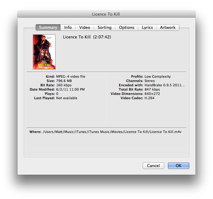

I converted this video with handbrake the other day from a DVD.
When I attach my iPod classic, it says the format is incompatible, yet in Handbrake I selected the iPod format, and I'm pretty sure MPEG-4 is the right one?
Here is a screenshot with the movie's information;
Thank you for any help that is provided.
Get MediaInfo Mac, drag in the file, go to export, open the text file and paste the output here.
It's pretty not using the Baseline profile for x264.
Ok, here's the text file:

Boom! Needs to be Baseline.
H.264 video, up to 1.5 Mbps, 640 by 480 pixels, 30 frames per second, Low-Complexity version of the H.264 Baseline Profile with AAC-LC audio up to 160 Kbps, 48kHz, stereo audio in .m4v, .mp4, and .mov file formats;
H.264 video, up to 2.5 Mbps, 640 by 480 pixels, 30 frames per second, Baseline Profile up to Level 3.0 with AAC-LC audio up to 160 Kbps, 48kHz, stereo audio in .m4v, .mp4, and .mov file formats;
MPEG-4 video, up to 2.5 Mbps, 640 by 480 pixels, 30 frames per second, Simple Profile with AAC-LC audio up to 160 Kbps, 48kHz, stereo audio in .m4v, .mp4, and .mov file formats
In handbrake, after selecting the iPod present, check the 'iPod 5G Support' box. Then you can encode the file and it should sync 🙂
*Update*
After converting the video yet again from the DVD, this time with the iPod 5G support box checked, it still did not work- the codex remains as "Main"

If anyone has any further suggestions please let me know.
Thank you
