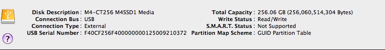

hey guys my mac mini still couldn't recognize my SSD.
below is the screenshot that i format it externally.
desaturated is offline   1 Reply With Quote
Old Jan 8, 2013, 06:54 AM   #9
mwhities
macrumors 6502a
Join Date: Jul 2011
Location: Mississippi
Send a message via AIM to mwhities Send a message via MSN to mwhities
Quote:
The only thing I can tell from here is a bad cable inside the Mac mini. It works with USB so, something inside is not working.

desaturated
Thread Starter
macrumors newbie
Join Date: Nov 2008
Quote:
Originally Posted by niteflyr View Post
Check startup drive setting in system preferences. Make sure SSD is selected.
Thanks i will check it out.
Quote:
Originally Posted by cocacolakid View Post
What do you mean "no luck" using ethernet and internet recovery? "No drive detected" either means the SSD isn't formatted or it's dead.
Some SSD's have given me problems cloning them externally and then installing them, but not all are the same. Good luck.
I am not a fan of cloning too, always preferred fresh install to new drive. But my ISP keep blocking port of -4403f. Thus i was unable to use internet recovery.
desaturated is offline   0 Reply With Quote
