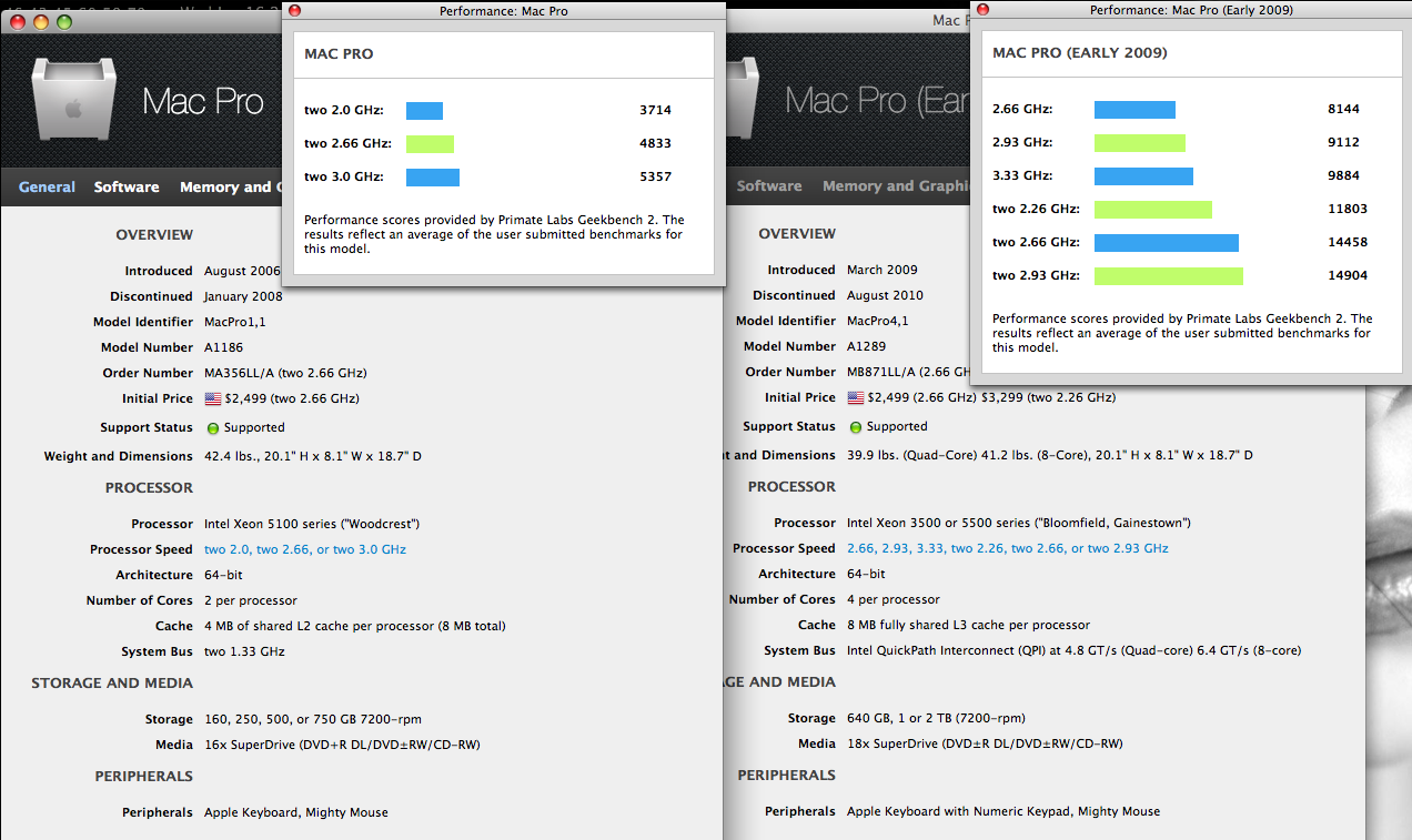

I can give you a screenshot of your MP 1.1 specs and the other one is a MP 2009 4.1.
Now, I am no expert but if that is the model it should be quite a bit faster.
Included in the screenshot are geekbench results
Click image for larger version

He could be using 5355's hence the change from 3.0 Ghz
If he's on 8 cores at 2.66 then his GB is 10,000ish like mine

Your MP and Mine are rather similar, I score 10,470..You'll be at 13K or so with the new one. You'll get cheaper RAM with a higher RAM limit, it'll use less power have PCI 2 and be up-to-date.

Originally Posted by derbothaus View Post
Stay away from the 2.26. It sucks at Adobe suite. Clock way too low and not enough turbo biasing to make up for it. Side grade at best. Maybe trade for it but don't put any money into it. I'd use any dual 2008 over a 2.26 2009 or 2.4 2010. Unless you have gigantic memory needs in Lightroom.
I also considered the 2.8 5.1 (essentially a couple hundred more used), eventually putting in the 3.33. The GB is a couple thousand more on the 2.26 that's why I was leaning that way.

Quote:
Geekbench is not very indicative of Adobe PS/ Lightroom performance. The 2.8 - 3.33 is the better upgrade.
