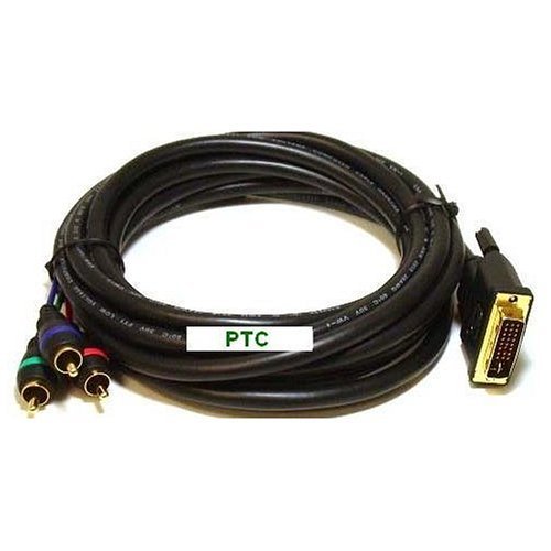

OK so I've recently had the urge to hook my MBP up to my TV. My TV is HD-Ready but has no HDMI in port. Only component video. Will this work for me?
Linky
Picture:

Not having actually tried it with that kind of cable I can't guarantee anything, but that looks to me like exactly what you'll want. It'll be using the analog output embedded in the DVI output, not the digital, but that's all your TV supports anyway.

OK so I looked into it a bit more (I <3 wikipedia) and found that I will most likely be getting RGB composite video from this connector, as that is what the analog part of the DVI connector puts out. However my TV uses YPbPr. :confused: I'm a bit confused about the whole thing. Does this mean anything? Will I still be able to use this cable?

You'll find that that cable is only likely to work with DVI-I and the like. The output from a MacBook/MacBook pro is DVI-D, you might be able to get a similar cable that connects to a VGA port, and use that output from the MacBook Pro.
What I am trying to say is, that cables might fit together, but the signal is the wrong one, hence I don't think it would work.
Edit: Look at the cable closely, you'll notice 4 pins around the flat pin, these are absent on the MacBook Pro adapter (and needed for that type of output) the cable WON'T fit, don't buy it.

The male side on the cable is a DVI-I. I think that the MBP is a dual link DVI-D and apple offers a composite cable and S-video adapter just not sure that you will get component video out of the graphics card. This thread from Apple support forum suggests not.

Uhm, if you mean that the MBP doesn't have the four holes around the X or Plus sign thingly. You're wrong, it does.

12
xander,
i've tried that cable with my mbp and it definitely does not work. on my display preferences it shows it as outputting an RGB signal and not an NTSC signal that my TV could use.
supposedly, the ati x1600 requires an hdtv component adapter like the ones mentioned here:
http://ati.amd.com/products/hdtvadapter/index.html
http://cgi.ebay.com/ws/eBayISAPI.dll?ViewItem&item=290078684014
it sounds like the adapter needs some windows software installed to make it work. i haven't tried it, so i don't know if it would work on macs or not. i'm curious though.
