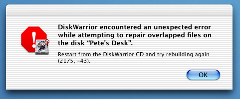

Went with Disk warrior, finds the problems, but craps out with an error just as it's finishing. I'll post it later. Ran it a few times to see if it would take care of it, but I seem to have overlapped files it can't fix...

Anyway, here's the story of my problem....
Once a month or maybe a little more often my dp 1.25 Kernel Panics when waking from sleep. It's just enough to really bug me, tried everything, reformat reinstall was a starting point, remove USB devices and drives. I only have a Canon s820 and Epson 1260. didn't fix it. I have a Lacie 80 Gig D2 Fire Wire Drive (my back up drive it also has a bootable system on it) and a Lacie CD Burner. All the devices and drives are pretty current, so I don't think they're the issue. I have spoke with apple and have taken the box to my local Apple fix-it shop, but I can't reproduce the issue and neither could they.
I've ran the Apple Hardware tool for 24 hrs in loop mode with no errors, I have reset the PMU and Zapped the pram, but the once and a while kernel Panics won't go away
Anyhow, the kernel panic is usually followed some other hiccups, so a repair permissions and disk repair usually take care of that. This time, however I have the two cross-linked files. I figured I would move them and run it again, but I can't open the files. The folder they are in has a little red circle with a line through it in the corner, and in the get info window, the owner is system. Can't you do something like log-in as root to get to that stuff????
The files are located Private/Var/Spool/cups/tmp/[File name is about 16 digits of letters and numbers]
I don't know *nix, so I don't know what they are and I can't get to them through the finder, to move or delete them. They seem, by the path name, to be temp files.
I attached the error I get from Disk Warrior

Oh boy that sounds bad. It could be that there was a problem back when the OS was intalled and that's what's causing the strange bugs. Anyway, I'd reformat and see what happens, if it still has problems I'd say its a hardware issue.
