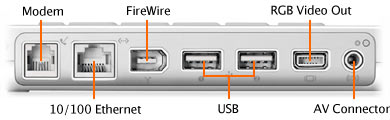

This is a mini VGA plug:
This is the Apple output (Labeled "RGB output")

The video out port (that's being referred to as a mini-VGA port above) is not a mini-DVI port. They're two different things. The 12 inch powerbook is the only apple product (to my knowledge) to use the mini-DVI port. Looks almost identical to the video out port, and the connector pictured above is also almost identical - for both the video out port and the mini-DVI port. When that sort of adapter is used, you get S-video and (yellow, video only) RCA output, as noted above. My girlfriend's got the iBook (video out) adapter, and I've got the 12 inch PB mini-DVI version. The adapters are NOT COMPATIBLE. So if you still want video out, make sure you don't get the mini-DVI adapter.

I think you are mixing computers up here. The iBooks and iMacs have mini-VGA, not mini-DVI. One is a digital signal, the other is not. (The mini-DVI is digital.) the mini-DVI comes on the new 12"PBs. And AFAIK that adapter shown at the top of this thread will allow you to connect either an S-video or an RCA video-only connection to your external monitor (most likely a TV with those connectors, the mini-VGA to VGA adapter for a computer monitor comes with the iBook).
