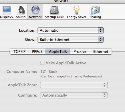

In OS X, make sure Appletalk is enabled under the network preferences (like in this screen shot) and that Appletalk is set to Ethernet under OS 8 (Control Panels > Appletalk.) Go to the chooser, click on AppleShare and you should see your iBook listed there.
If not, there might be a box that says specify IP address, you can click on that, then enter the IP address of your iBook and that should do it.
Hope this helps...

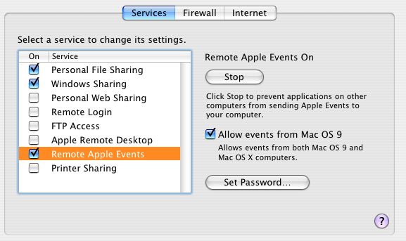

Make sure you have your iBook Sharing preferences set up correctly and that you have the "Allow OS 9 Events" checked in Sharing in System Preferences.
