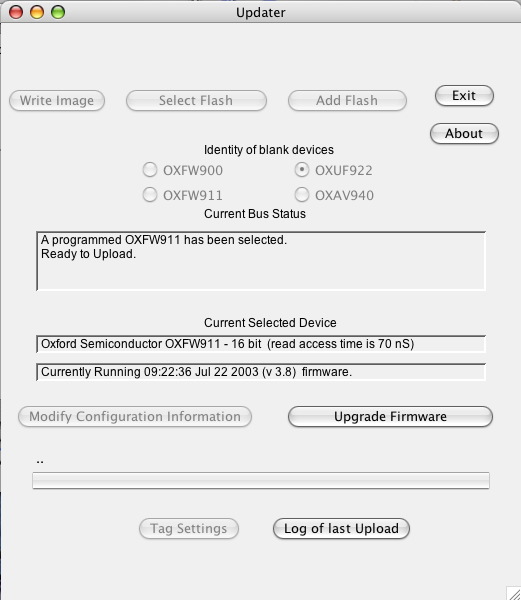

ok, i went to the company that made the enclosure, and there is updated firmware to download, but in the folder i downloaded there are many different versions, and there is no read me or anything...
anyone have an idea
my enclosure is:
"Bytecc 3.5" HDD Aluminum Mobile Enclosure, part number ME-35OF (IEEE 1394)"
It seems to me that you have.....
the OXFW911 Chipset by looking at the selected drive in the firmware updater.
Just to be sure, plug in the drive and go to "About This Mac" in the menu bar and click on "More Info"
Click on "firewire" in the left panel and then look at your device in the right panel. It should say one of those chipset numbers listed. That in the one you want.
the Oxford 911 is a quality bridge, so i wouldn't worry about that -- it's most likely a jumper thing. try slave and cable select.
also, have you tried the drive in known case to make sure the drive works? i know most people don't have spare enclosures lying around, but maybe a friend has a case you might borrow.

i got her going, thanks for all the help, and excellent advice!!!
...And the solution to your dilemma was what exactly?🙁
set the drive to channel select
and update the firmware to the newest version
i was either doing one thing or the other, but never both at the same time... which was the problem
