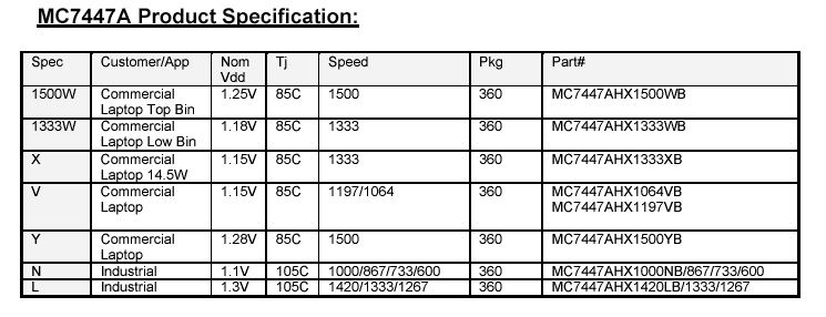

You see specs in °F
I see them like this... Tj = Junction Temp (Max) (°C)
Which is on the PPC product page spec though it limits the top speed -- as we saw between the iMac and the PowerMac.

So clearly, from the Motorola specs the 7447a is designed to be running at temps of 85 degrees Celsius. So what is the problem. Remember we are talking about the temperature of the processor itself not the temperature of the air around it or the temperature of the outside case (which is why you would not be burned by a laptop with a processor hot enough to boil water in it).
If the temperature of the air in the computer was 85 degrees Celsius. There would be more of a concern.
I think gist of this is that if your processor is running at these temps... all is well.
