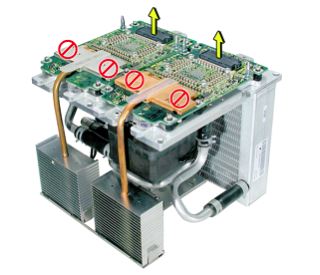

I just looked in the new updated g5 service manual and the watercooling set apple used looks insane

ah screw it grab it while you can
heres the bottom of it
it's all one unit as a service part

Liquid passes over the processor to carry the heat away with it, there is also a regluar fan on top of it in this case by the looks of things to help out. The heated water then passes through a radiator/heater core to dispense the heat before going over the processor again and so it continues. That's how it normally works.

those pictures are interesting! Hector, You say its one serviceable unit. Hmm... So if this sucker breaks or leakes then you have to have the whole thing replaced. Ouch. I wonder what could be the price on this unit
Sweet! That's a pretty serious effort, the radiator is huge! Looks like the heater core for a car... 😀
The explanation was it's a power density issue related to the same power dissipation in a smaller area that led to the need for more efficient cooling.

The way I understand it, the two most important things to water cooling (barring breakage) is radiator and reservoir. The radiator does it's purpose just like a normal heat-sink, being that it merely cools stuff. The reservoir is the part most people over look and the most important in my opinion. The larger the reservoir the more water there is to heat up, and thus the longer it takes to heat all of it. This means that if the G5 had a reasonable size reservoir (which I don't really see) then it could practically run silent, because even when the CPU(s) are running 100% the water all of the water in the system wouldn't get too warm and thus could be cooled slowly over a longer period of time. The only problem would be if it ran 100% all the time, then thats where radiator construction comes in.
It is now that I would like to point out there are heat pipes running under the the logic board that are near, but not actually under, the CPUs. Does anybody know what that is all about? Possibly some kind of system bus?
