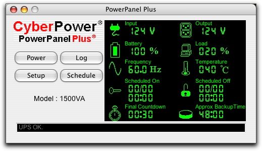

Similar thing happened to me. Lesson learned: always get a UPS, not just a surge protector. If you can afford it, get one with USB connection to your Mac (CyberPower makes decent systems, many of which work with Macs). A good UPS will protect you from surges, sags, over-voltage, etc., and one with software that runs on the Mac will actually let you see conditions as they currently exist on your power line. As you can see, my voltage is a bit high now. If it gets much higher (or lower), the UPS will manage it for me and output 120V.
