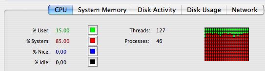

The tittle pretty much says it all.
Well, I don't know what to do.
I've repaid permissions twice.
Logged out.
Restarted twice.
When I go into the Activity Monitor, my CPU is running 100%, and 80%+ is coming from the System. I've tried to sort the processes by how much they use, but no single process is taking up more than 5%, and most of them read 0%.
It's not the Finder, as some other people have reported.
Any ideas?
btw, I've mad sure to quit F@H. 😉

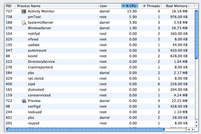

sort by CPU, or whatever you have to do to find which processes are going full blast. Sometimes, I get a WindowServer process that acts up, and I log out and back in, and that fixes the problem.

Check out the pic below, from the number below, I should only be using 27.6% of my CPU, but the monitor sill says 100%.

It is almost definitely NOT hardware related from the sounds of it. My guess is that there's a hidden process not showing up in Activity Monitor. Type "top -o cpu" in Terminal to run the process manager and sort entries by cpu. This may reveal something that Activity Monitor isn't showing. Hopefully this will help you out.
