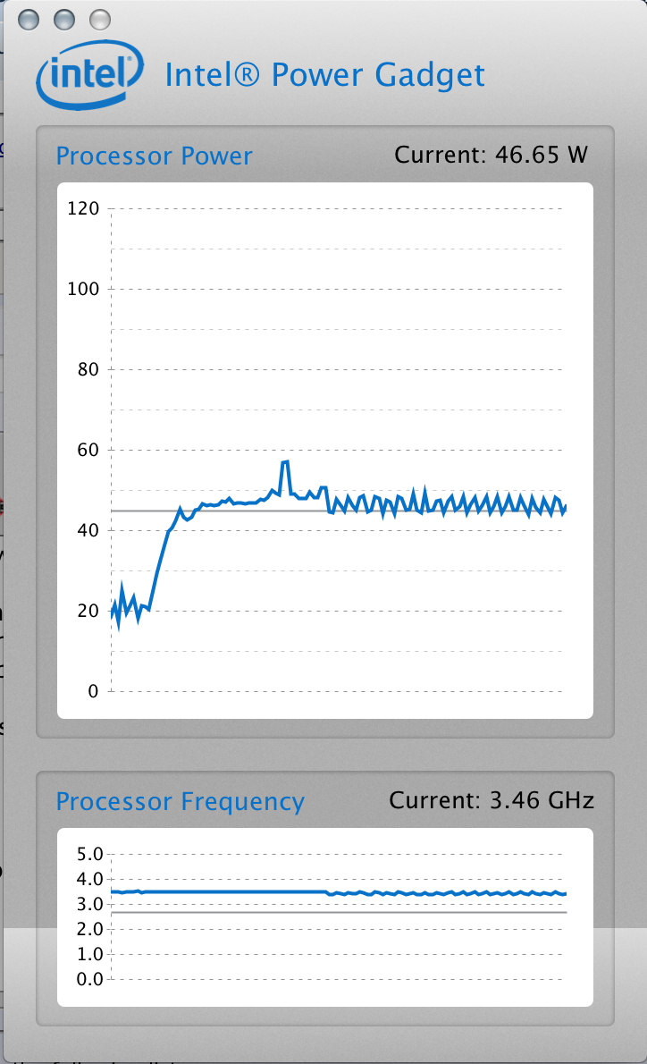

True.
CPU power jumped almost to 60W.
it starts throthling after 15secs approx to 3.40-3.45ghz, which is still more than 3.1ghz of 2.3 cpu
fans floating around 5k rpm afte 40secs, increasing after 1 minute to 5.6k and rising slowly towards 6k. (Left fan, right is at 5,4k!)
Right fan is always about 400rpm behind...

maratus
macrumors 6502a
Jun 12, 2009
701
273
Canada
True.
Right fan has lower maximum rpm by design, so it's normal.
