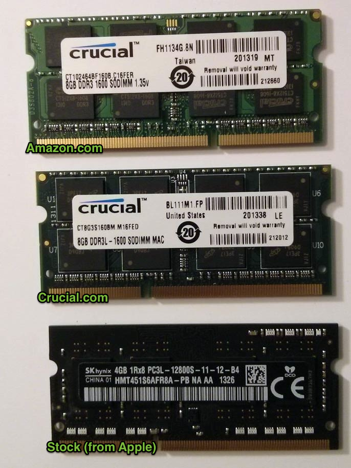

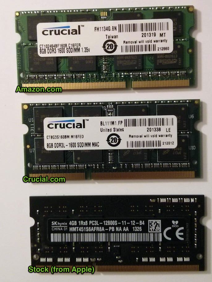

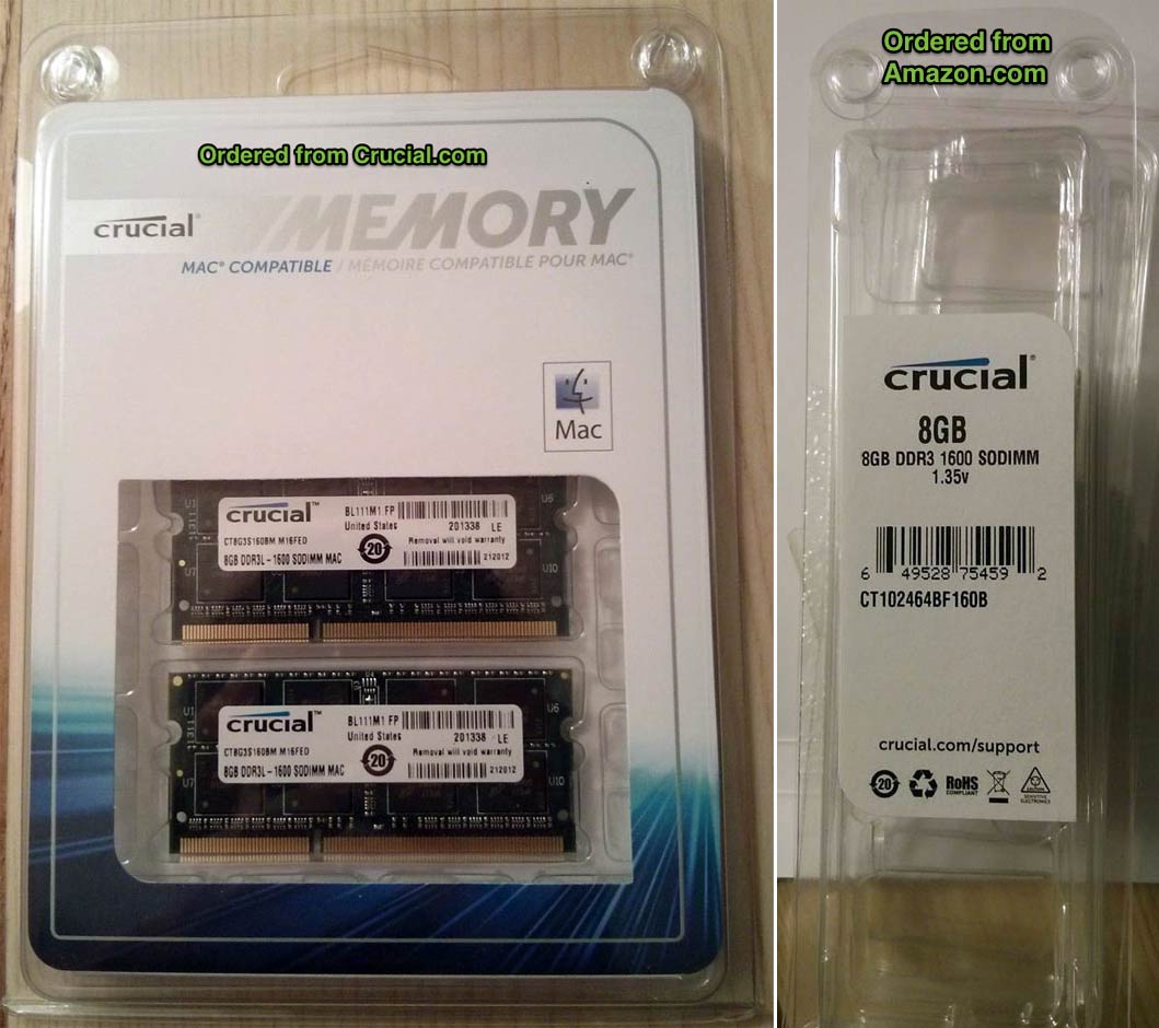

Ram pictures
I've updated the original post with my conclusion.
Attached are pictures of the ram I bought from Amazon.com, Crucial.com and the stock memory that came in the machine.
I hope my journey helps others down the road.

If you look to the pictures, you'll see that the modules from Amazon are DDR3 and those from Crucial are DDR3L (L= Low Power), so probably the overheating is related to this diffrence.
