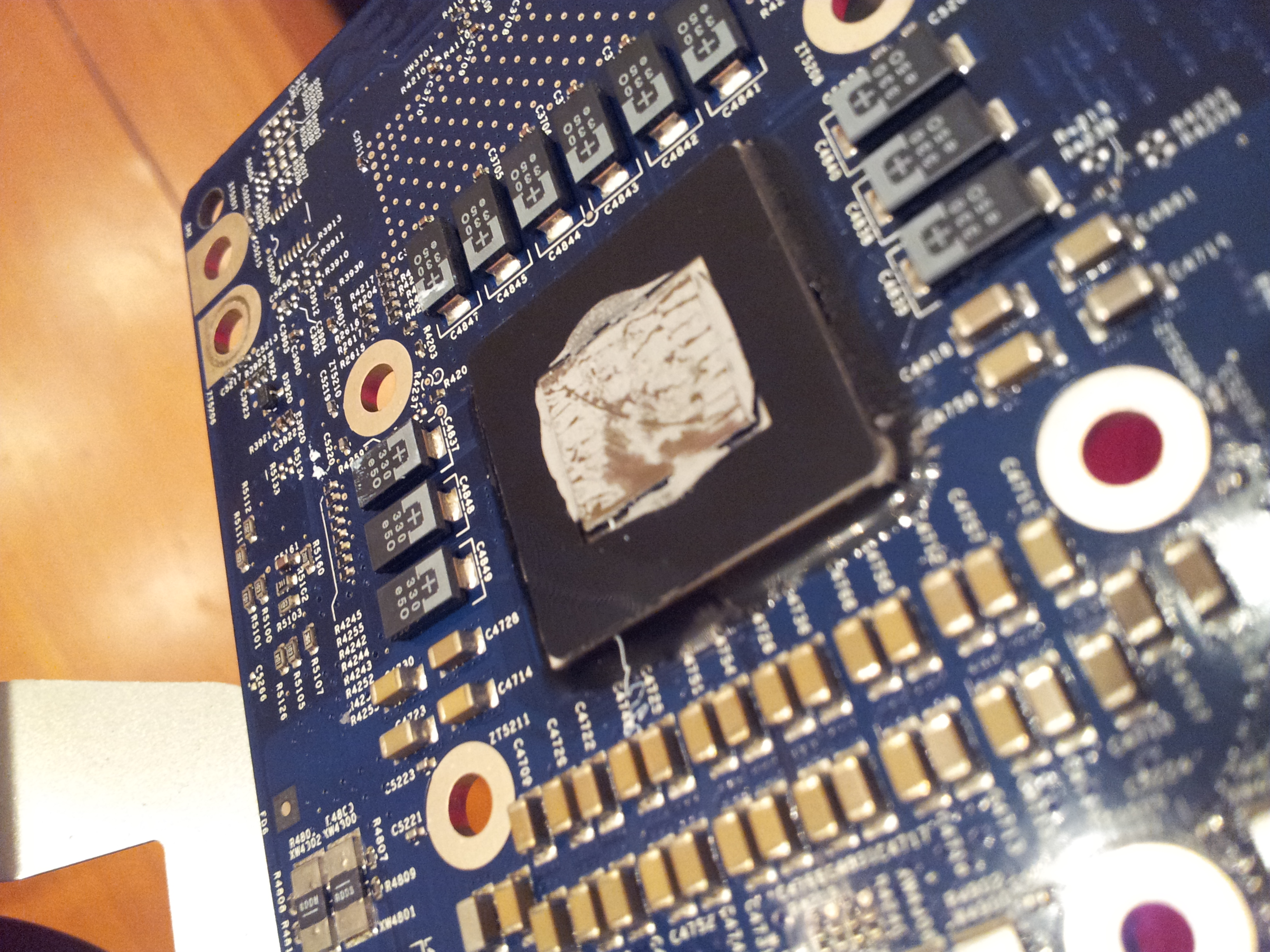

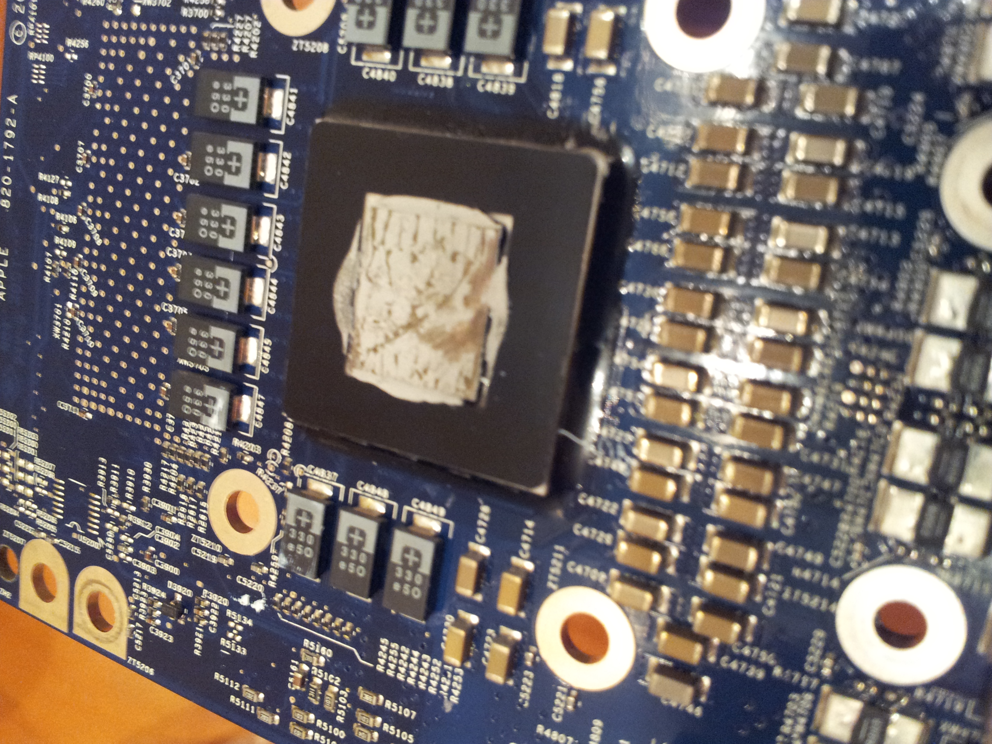

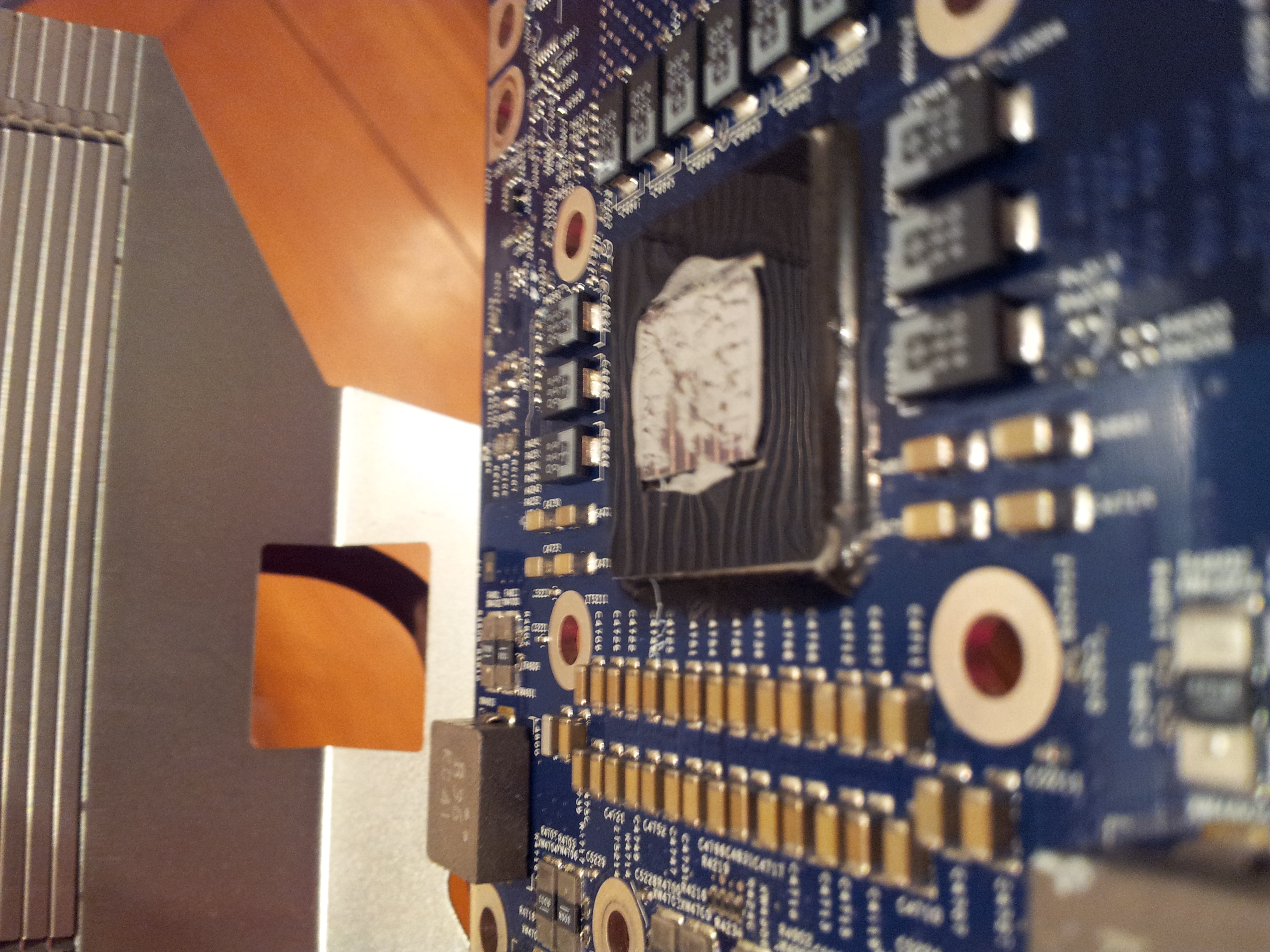

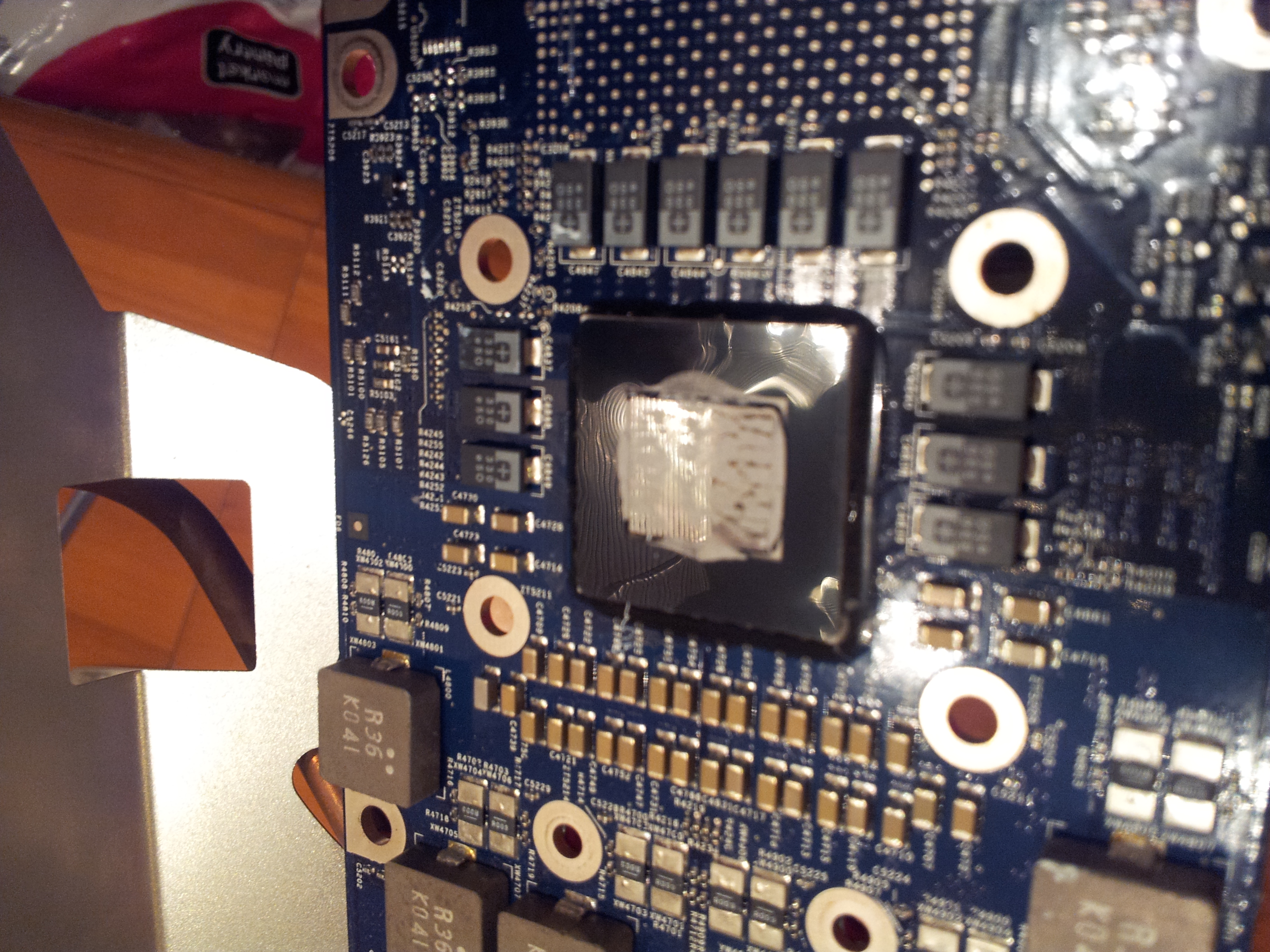

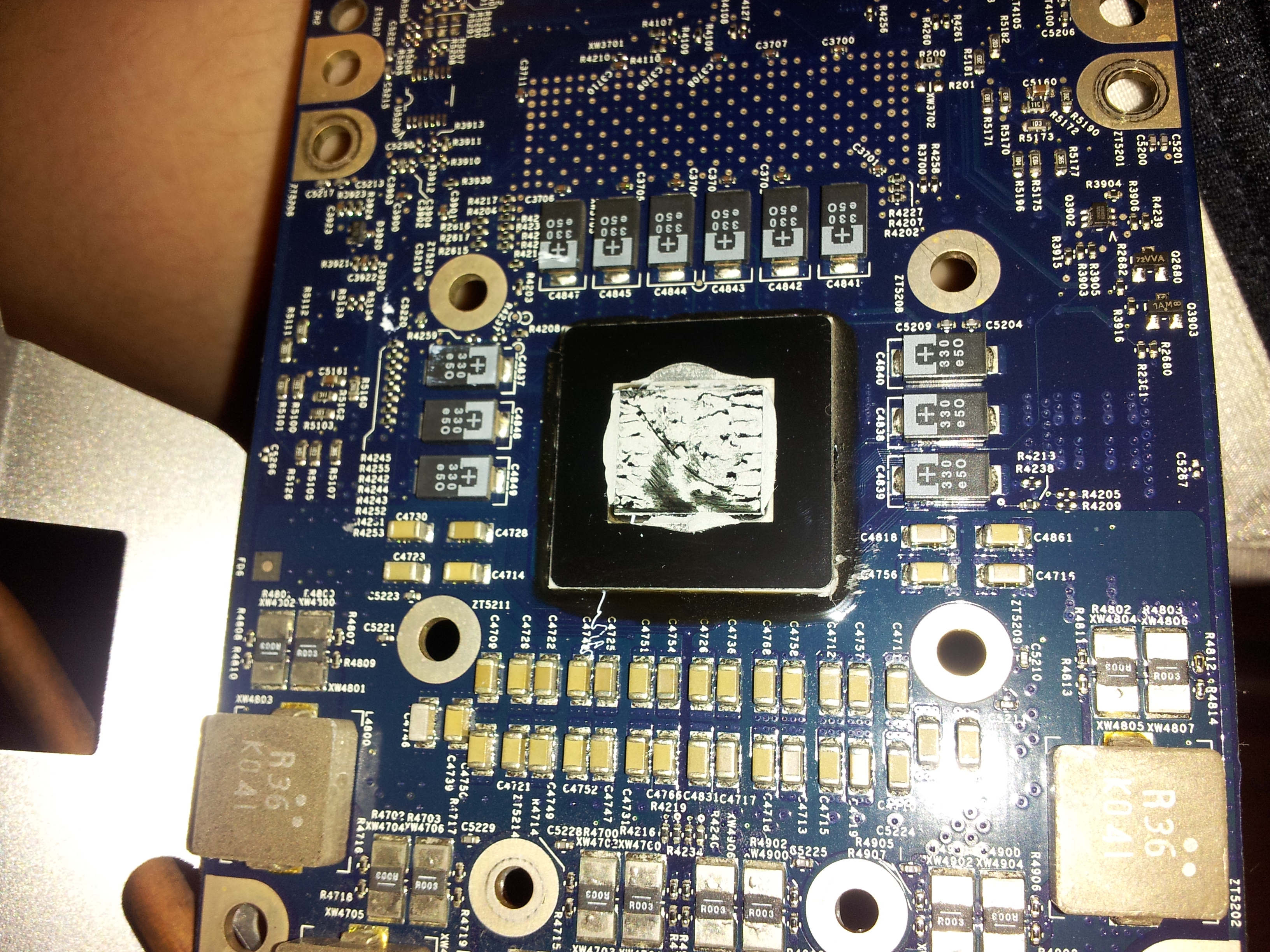

So a few weeks ago, I tried turning on my mac and the screen stayed black, and the fans just started going crazy. Haven't been able to get it to boot since. The computer will turn on, but within 15 seconds a red LED on the motherboard stays lit and then 30 seconds later the fans go crazy.
I've taken it all apart, cleaned it with an air gun, put it all back together, tried using good ram in different match slots and no luck.
I'm assuming now its the processor. Can anyone tell by these pics if my processor is bad?
It's a dual core, single processor (I think) 1.8 ghz G5 btw

I'm assuming thats thermal compound and not smoke residue. Is that line in the middle of the die a crack?
Other than that it looks normal

No, I don't believe it's a crack, just like a scratch on the white stuff.
But if you look at the first pic, on the bottom-left part of the processor you can see a white hairline crack that originates from the processor and goes off onto the circuit board....i'm wondering if thats maybe a short or something?

Thermal compound completes the thermal bond between the CPU and the heatsink. It's the dried pasty stuff in your pictures. The old stuff needs to be cleaned off and new stuff applied. A lot of us here like MX-4.
You cannot even put the old CPUs back in to test without doing this. Glad that you haven't. I misread your original post.
You will need fresh thermal compound even if you get a new CPU from eBay, so might as well get some now to see if it will boot with you old CPU (it's also possible that the problem isn't CPU related. See here for some G5 troubleshooting guidelines).
