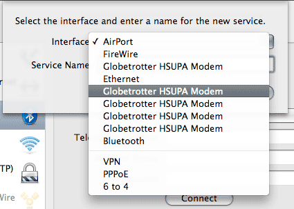

6: Go to your network preferences window, you should have a new location called "GlobeTrotter Connect", OPTIONAL BUT RECOMMENDED: Delete this location by selecting "Edit Locations" from the location menu.
7: Back in the Network preference pane main window, you should NOT see a list of GlobeTrotter modems in the left hand pane. They will have been deleted by the GlobeTrotter software when you hit connect. If you see them, go back and repeat step 4. If you still see them, delete them one at a time.

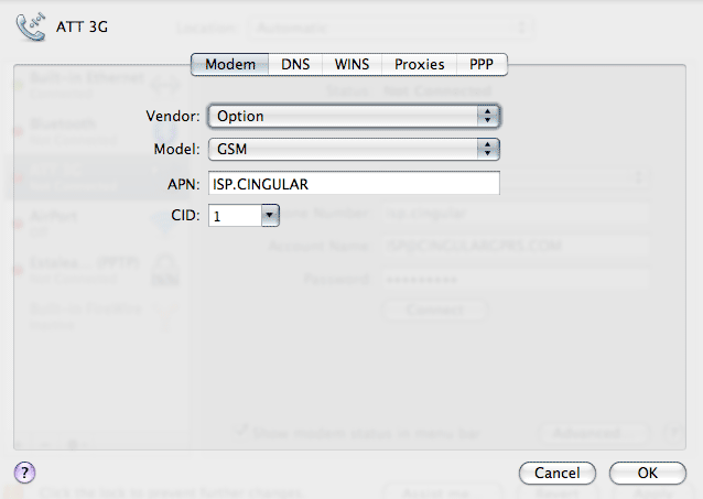

8: Hit the little plus button at the bottom of the list. From the "interface" dropdown, select the SECOND "GlobeTrotter HSUPA Modem" from the list. (NOTE: It was the second one on both machines for me, but if this doesn't work, try the others in sequence) and choose a name, the name can be whatever you want. I recommend "Crappy 3G Card From Evil Craptacular Corporation". Choose whatever you think is best and hit 'Create'.

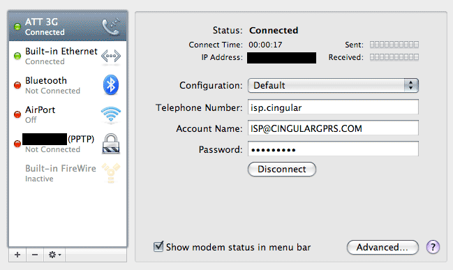

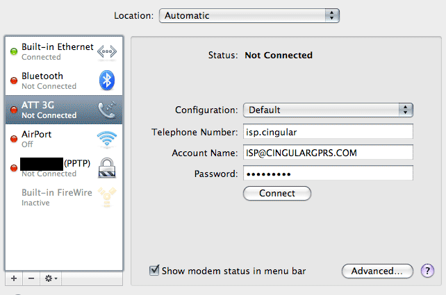

9: Enter the following information into the configuration screen:
Telephone Number: isp.cingular
Account Name: ISP@CINGULARGPRS.COM
Password: CINGULAR1
10: Click the "Advanced..." button.
11: Choose "Option" from the "Vendor" dropdown in the "Modem" tab. The rest of the values will change accordingly, and they're fine. Hit the "OK" button.
12: Hit "Apply" then hit "Connect"
13: Be happy, but still slightly angry.

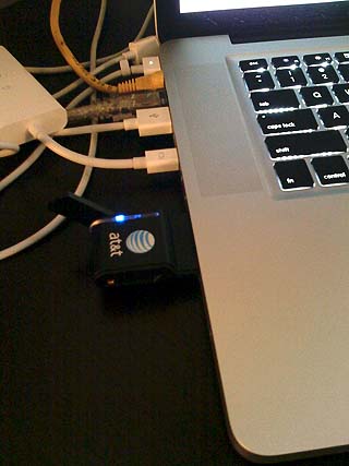

Not Quite. My workaround above is in fact for the Ultra card (I can send you a photo if you want) and uses the driver from the Option Globe Trotter connect software, which is why it has to be installed.
In that sense it is not truly "native", but you don't have to use the Globe Trotter application to connect, you can use the menu bar modem control and it doesn't shut down your other network connections (it doesn't switch locations) when you connect. That's not perfect, but it's a good enough solution for me.
I am NOT using the Launch2Net drivers. I'm using the Globe Trotter drivers. I've run this on a machine that has never had Launch2Net installed and it works fine.
