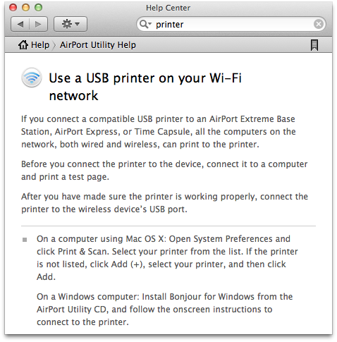

No, I don't. As far as I can tell "sharing a printer across the network" still works. Plug it in, go into System Preferences->"Print & Scan", and you should be able to add a new Bonjour printer without any configuration necessary.
Then you have no idea what you are talking about. We are talking about a feature on the Airport Express, Airport Extreme and Time Capsule that do not run MacOS X. These devices are controller by a software tool called Airport Utility which can be run from either MacOS X or Windows. With this utility you can set up printer sharing in version 5.6 and lower by clicking on the "printers" tab. In 6.0 this option has now disappeared.
What you are suggesting will require the use of a Mac which can be a problem because not everybody will use a Mac (you don't need one to use the Airport products, you only need Windows or OS X) and it requires this machine to be always on as it now takes over the role of print server from the Airport device. If you have a notebook this is quite problematic as well as something like a Mac Pro because of the energy it needs (as well as the noise it makes). The Airport devices excel in this area.
Yes, but you don't actually need the options to share a printer, do you? I never had a use for that configuration pane.
How I do it does not matter. The problem in this is very simple: one used to be able to do it and some people took advantage of that. Apple updated the utility and removed the option. How are these people supposed to control their printer sharing? As far as they know something that could be done before now is not possible any more. To them it looks like the Airport device is broken. Some will be very pissed off and look for other options that do work. Like I said that would mostly be any competing routing/ap product out there that has the same low energy usage as the Airport products have. Btw, with your reasoning one can argue if you even need to share the printer, it has a cable you can hook up. Heck, you can go even further than that and argue if you need a printer in this digital era at all. But that would be besides the point: Apple removes functionality, functionality people relied on and used. They don't announce this before the update nor give any solutions to overcome this problem. THAT's the problem. Your view is too narrow minded.
There's no need to go to that tab since the printer that you plug into the Airport base station is shared automatically, and can be added locally without any further configuration. The configuration pane is useful only for seeing a list of connected printers, changing their name, and optionally enabling WAN sharing.
It just works. ;)
Exactly, so the "it just works" does not apply there ;) I'm glad you are now recognising that you DO loose functionality with 6.0. But like I said, this is not the worst part. Not having logs and stats is far worse as you need it when there are problems.
:rolleyes: I never doubted that. I only addressed your incorrect claim that printer sharing didn't work anymore.
dyn said:
Basically you have to resort to other options if you want to share a printer across the network
No you don't. It just works.

You might want to reread your previous post in that case because what you are now implying is completely contradictory to your previous post. Can you or can you not change certain settings like name of the printer? If not then things clearly do not "just work" for those that need to change these settings. And for them the printer sharing simply "does not work". Is my claim incorrect? Absolutely not!

I give up. If you really think that "you have to resort to other options [now] if you want to share a printer across the network", so be it.
