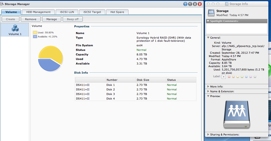

The USB ports on Synology NAS's aren't meant to be connected to a computer. They're to plug in external devices and drives. Hard drives, printers, Wifi Adapters, etc...
As far as what shows up, since the NAS itself controls the volume size, the info that will be shown to the Mac will be the actual size that is available. You can swap out different drive sizes as you wish, and the web-based manager will allow you to integrate them with the volume. Some units have hot-swapping, but not all.
Oh. Darn. Thanks for the info. I was hoping it could be used as both a NAS and a fast external HDD.
Can I clarify what you said about how Finder reports the drive size? So if your Synology volume has 1.47 TB of free space, it's Finder window will report "XX items, 1.47 TB available" at the bottom? (The Drobo was not like this.)
Thanks!
It works like you think it should. Almost. Attached image is mine. There appears to be a slight variation in the reported numbers, but it isn't like Drobo where it reports the maximum size. I assume that the variation is unreported formatting/RAID loss and the space needed for the NAS' operating system.
I should note: Below is with 4x3TB drives.
