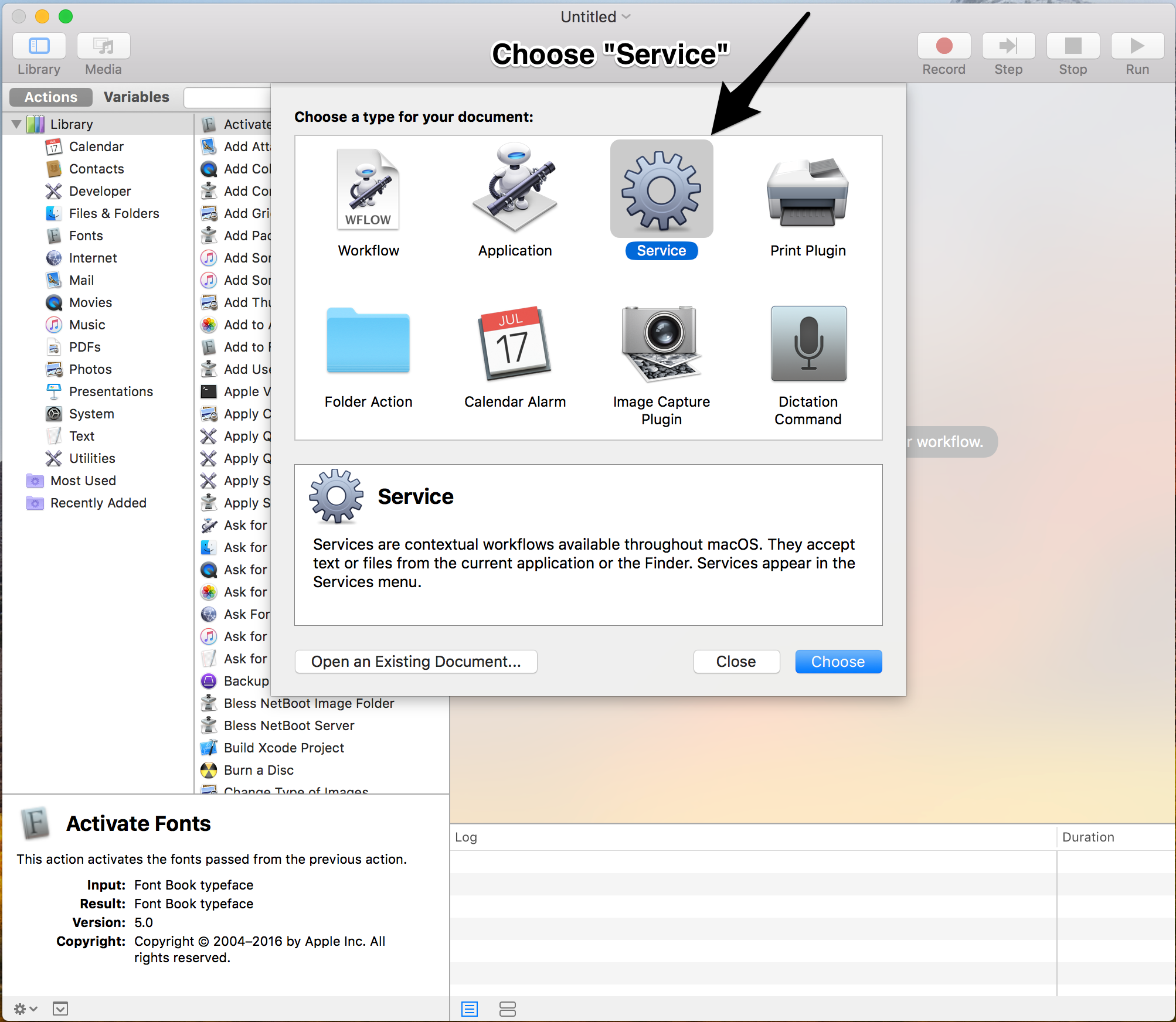

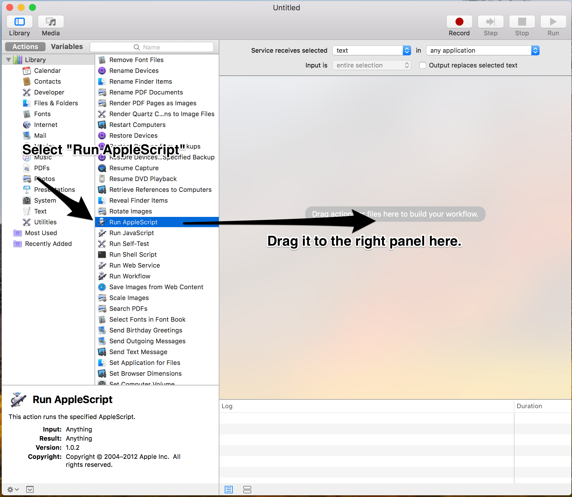

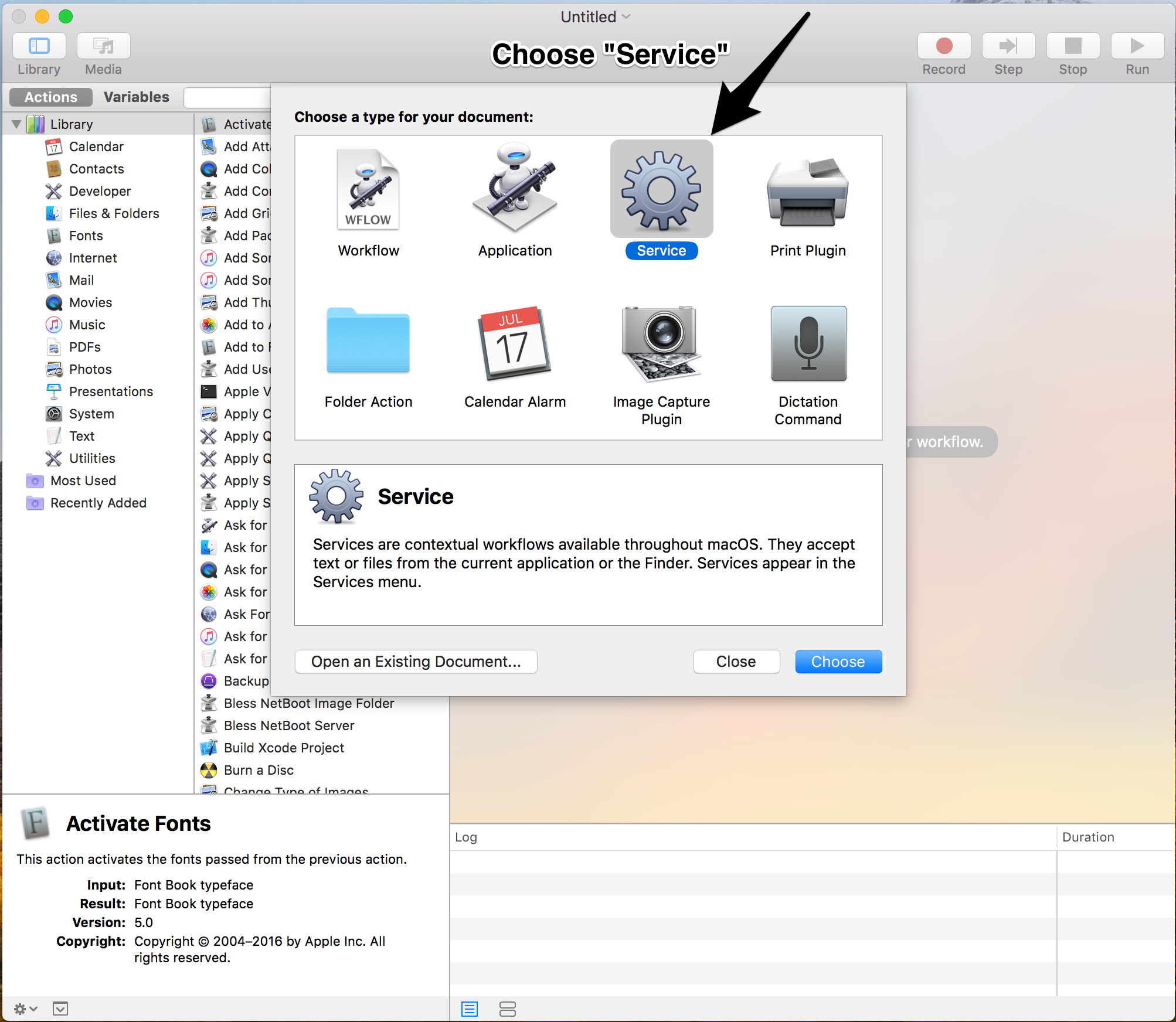

1.) Open Automator. It should be in your "Applications" folder. Or hit Command+Spacebar and type automator to find it using Spotlight.
2.) Select "Service":

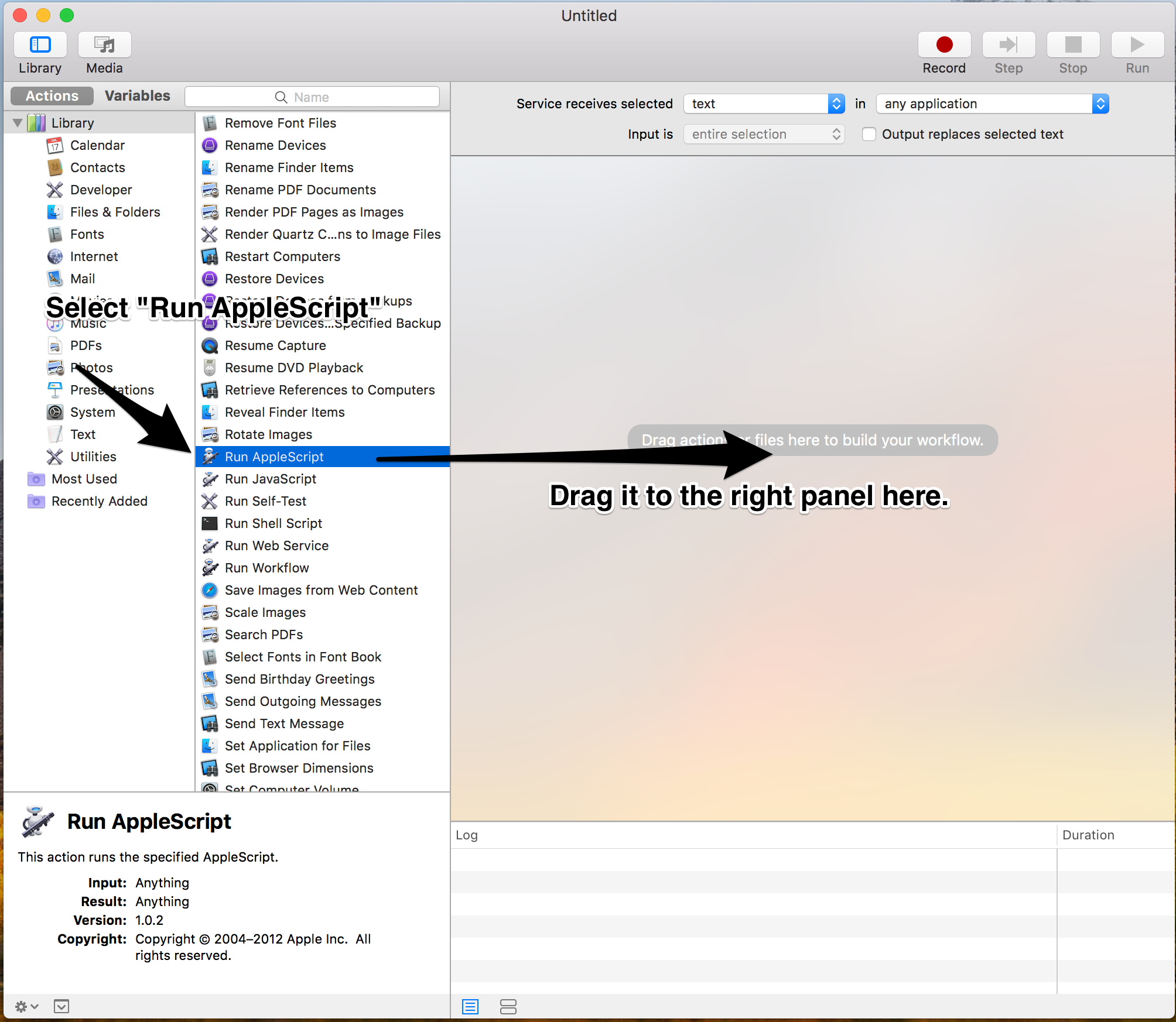

3.) Select "Run AppleScript" from the column of available actions. Drag "Run AppleScript" to the right empty pane to begin.

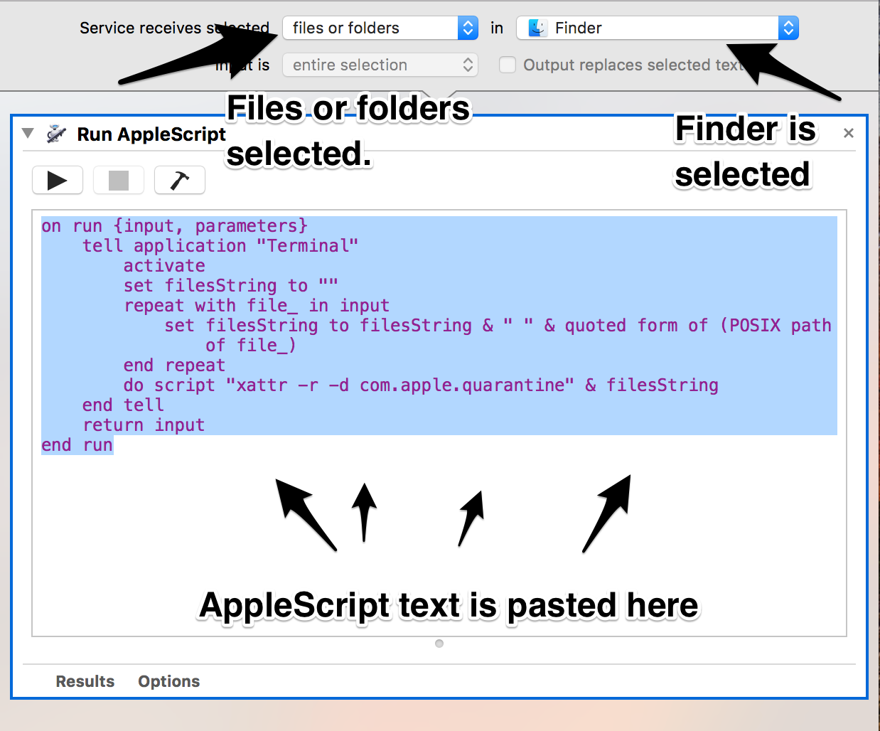

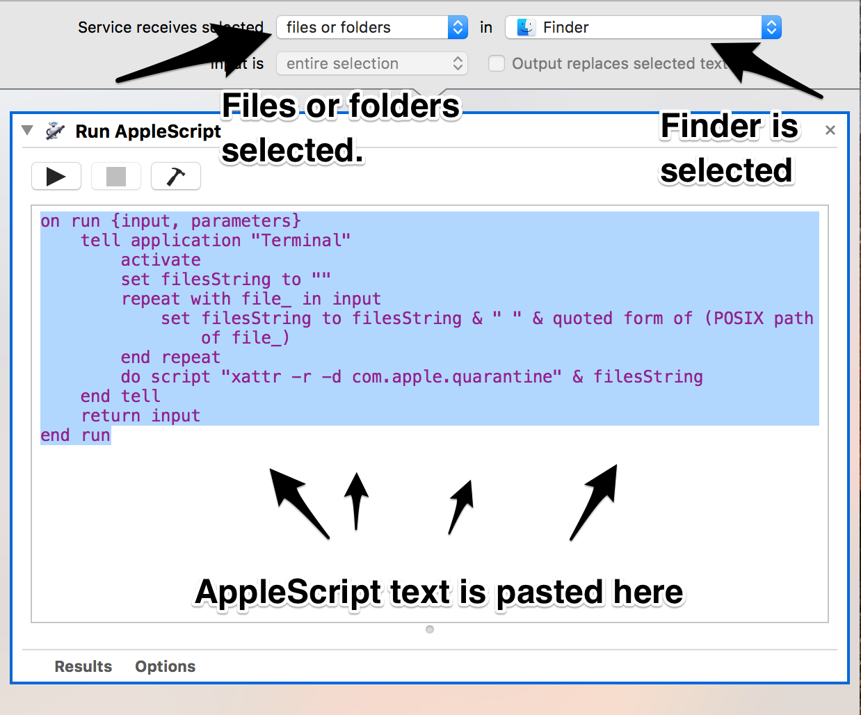

4.) Make sure "files or folders" is selected for "Service receives selected". Make sure "Finder" is selected for "in". Paste dolphin842's code in the empty text area shown in the screenshot below (I added "-r" so this is recursive):
Code:
on run {input, parameters}
    tell application "Terminal"
        activate
        set filesString to ""
        repeat with file_ in input
            set filesString to filesString & " " & quoted form of (POSIX path of file_)
        end repeat
        do script "xattr -r -d com.apple.quarantine" & filesString
    end tell
    return input
end run

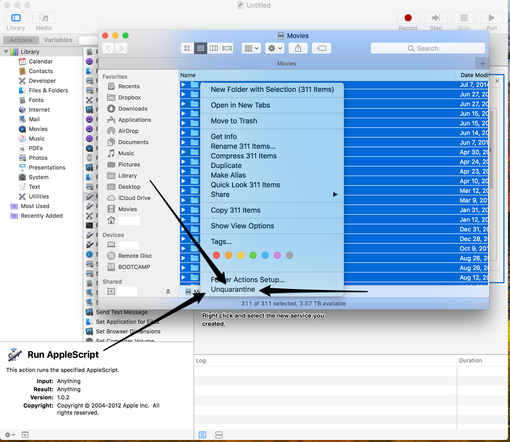

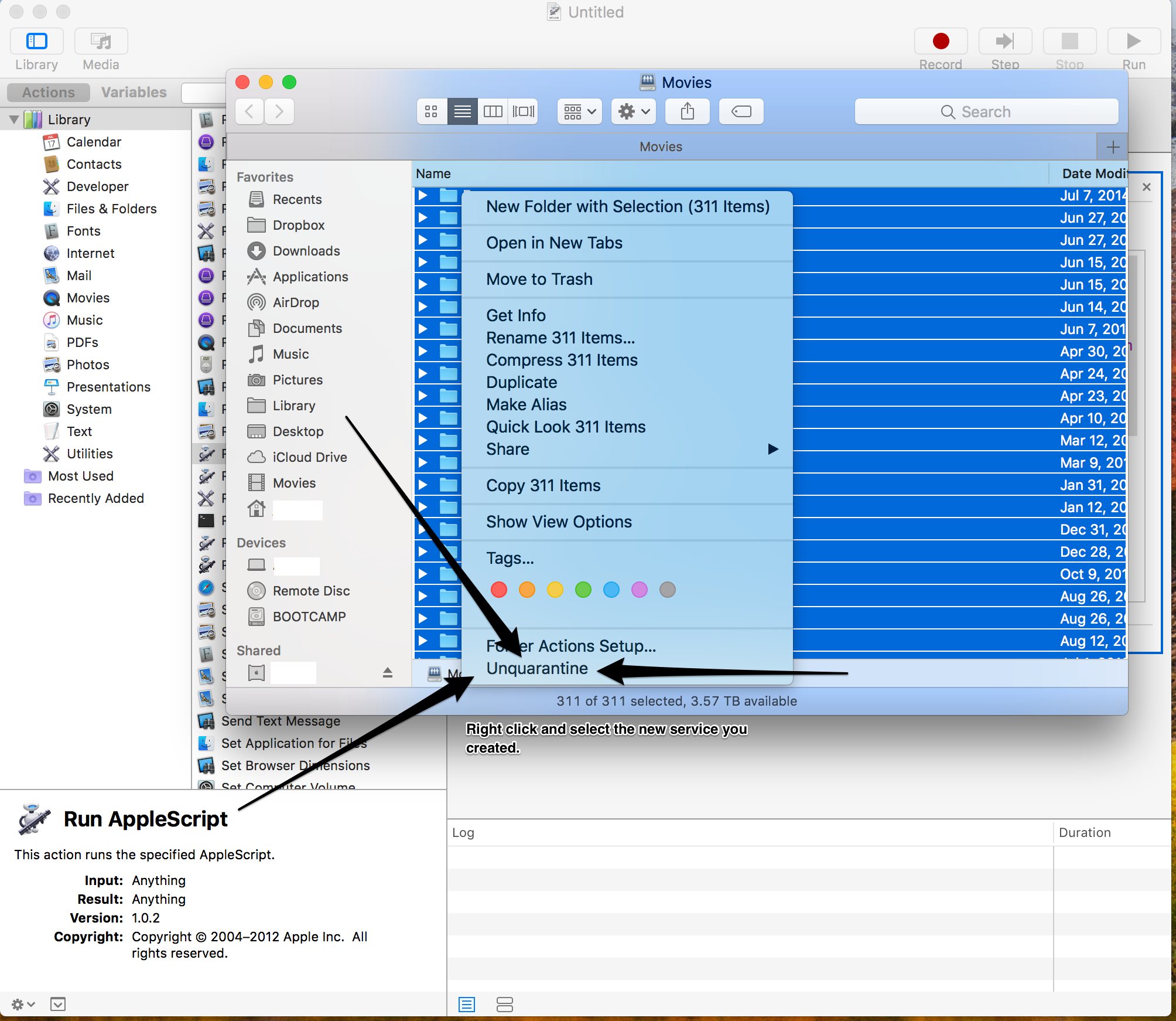

6.) Select all of the files you want to fix, and right click. You'll see your new service at the bottom of the right click dialog as a selection:
7.) Click "Unquarantine" (or whatever you named it) and it will modify all of the selected files, including files within selected folders.
