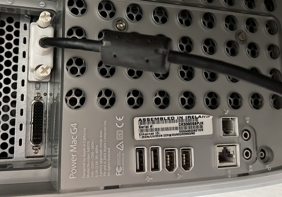

And no - it is not an MDD FW800 model.
(Nor does it have a FW800 mobo.)

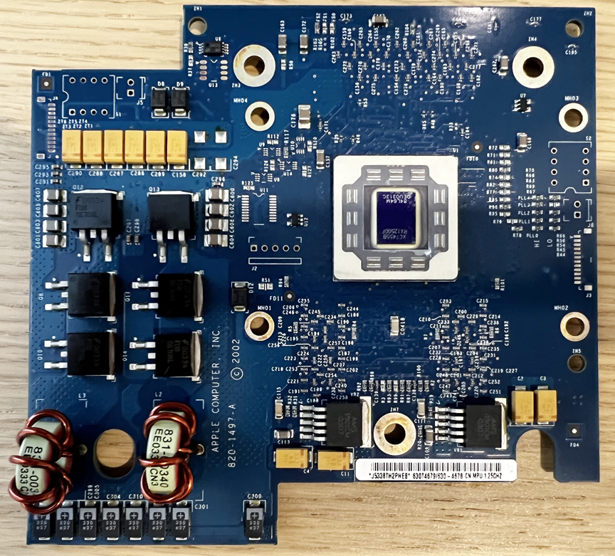

I don't see any pictures over there. Did he ever say what CPU he's using? I thought OS9 doesn't play well with CPU upgrades? It sounds like you guys have checked everything else.
Believe it to be the stock 1.25 SP CPU.
And yes, must sign in there to see pics.
But here's a pic of CPU.

Currently wondering here if Apple ever produced a FW400 MDD "Education model" that was “OS X only” but can find no reference of such a thing.

According to Mactracker, that MDD 2003 model was likely sold without OS 9 at some point, but there's no indication that there was a change in the logic board preventing install or boot of OS9, but Apple simply sold some without OS 9. So, I think you can still say that if a MDD had FW400 ports, then native OS 9 boot should work.
FW800 ports, no native OS 9. Maybe that was related to the release of Panther (I don't remember...)
According to Mactracker, that MDD 2003 model was likely sold without OS 9 at some point, but there's no indication that there was a change in the logic board preventing install of boot of OS9, but Apple simply sold some without OS 9. So, I think you can still say that if a MDD had FW400 ports, then native OS 9 boot should work.
