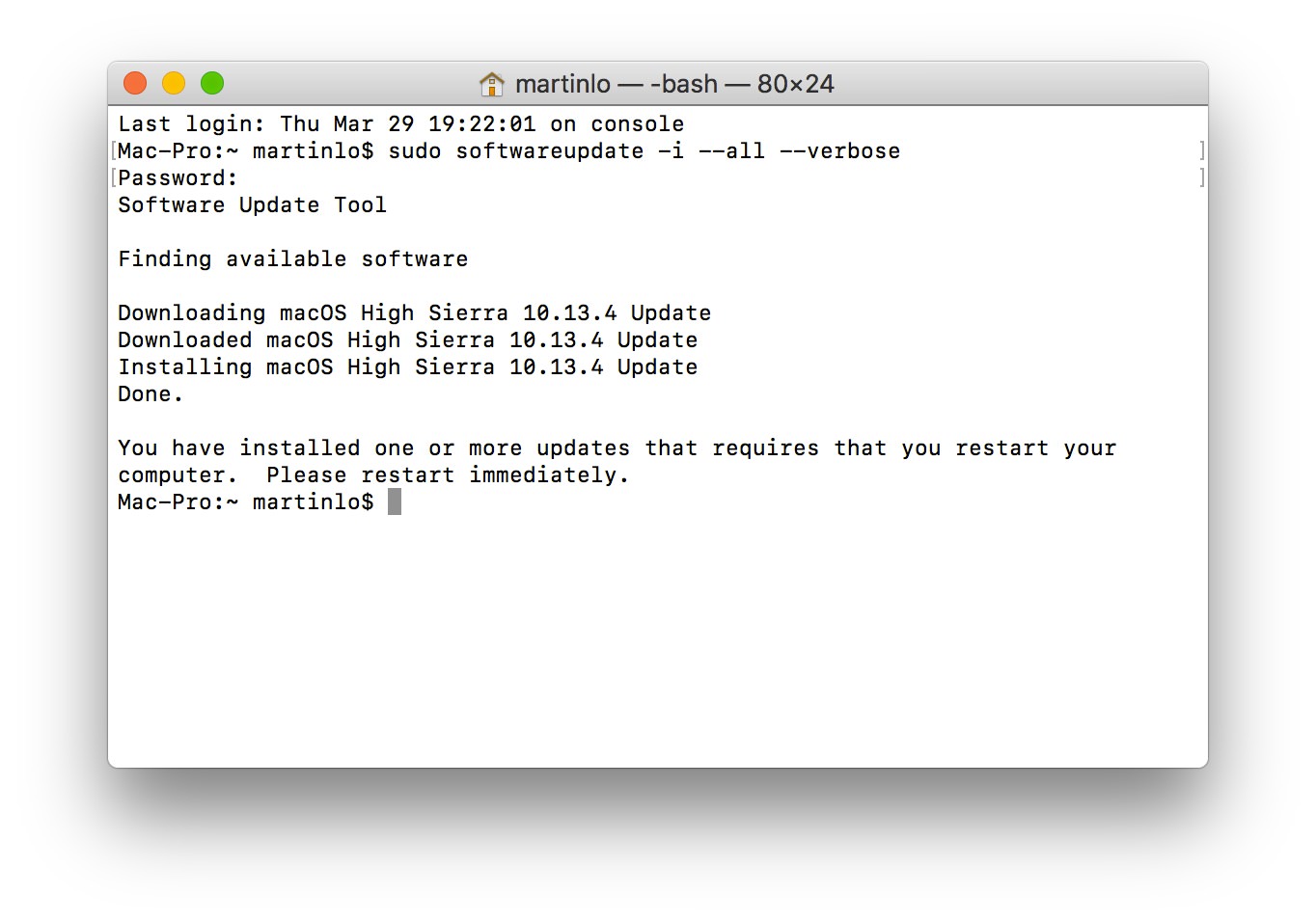

I usually update the OS via terminal, and never have any issue.
This time, it says completed, but actually nothing updated after reboot, still 10.13.3 (17D102).
I can keep repeating this process, nothing will be changed. And Appstore says no update for me (unless I run that terminal command).

I use the softwareupdate -l command to trigger the normal update shows up in Appstore.
So, I go for the "normal" path. Everything has GUI.
It downloaded a few GB files from Apple, pretend ran the update (I actually see the Apple logo, progress bar, and how much time left below the bar). But after restart, still 10.13.3.

Just fixed my own issue.
Still no idea what's wrong, but after performing the firmware update from the HS full installer. The combo updater successfully update my OS to 10.13.4.
