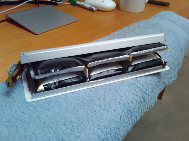

I use 13" white Macbooks in consoles (vending machines) and of the 20 i have in the field every single one of them has suffered from a swollen battery, and in some cases failure rate is re-occurring within 12 months.
I have given up using genuine Apple batteries, the cost is too high, if they are going to fail might as well use cheap non-genuine ones for $40. It seems obvious Apple never solved the issue but rather just replaced batteries and trusting another couple of years will see out the life of the Macbook.
We have measured the temps in our consoles, they are well within the recommended operating temperatures. My only conclusion is that because we run these macbooks 24/7 and with AC power always connected that accelerates the swelling of the batteries.
Therefore I think this indicates that if normal macbook users are also suffering from the swollen Macbook problems, then it is because you leave yours turned on and connected to AC way too much. I could be wrong, but I think that our experience with over 20 macbooks in controlled environments is significant.
Here is an image of a Battery that failed 2 weeks ago, after 4 years of dedicated service. It astounds me that it lasted this long, some have failed with only a mm or two of swelling.
I have given up using genuine Apple batteries, the cost is too high, if they are going to fail might as well use cheap non-genuine ones for It seems obvious Apple never solved the issue but rather just replaced batteries and trusting another couple of years will see out the life of the Macbook.

That pic scares me 😱
