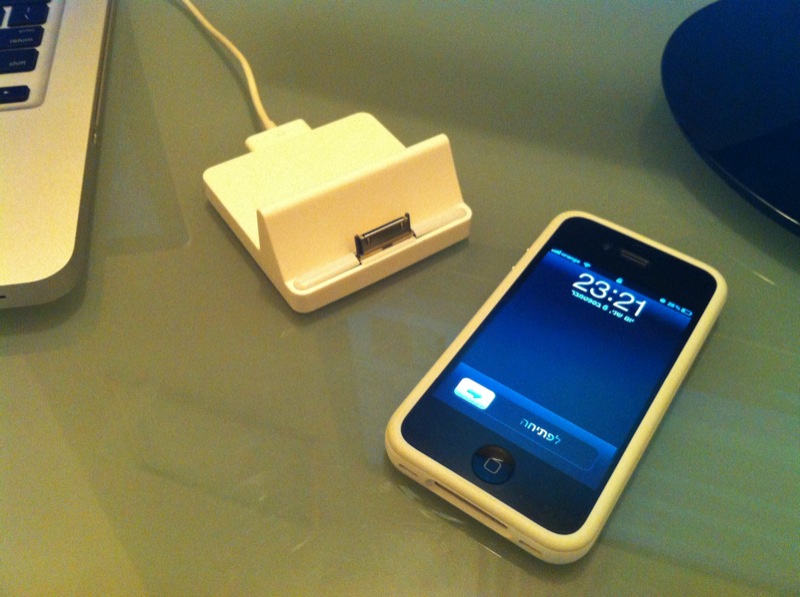

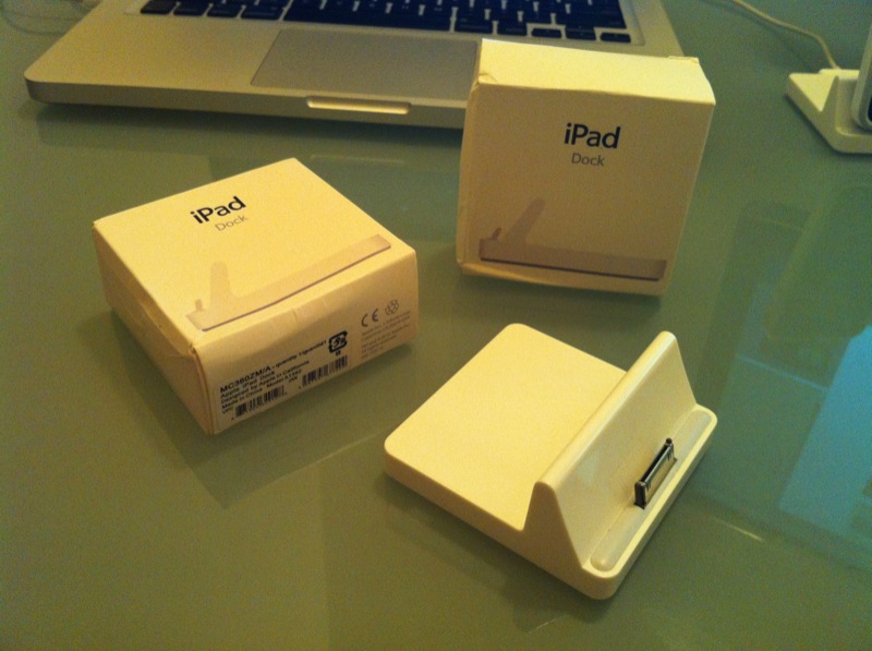

Hi Guys, i just got 2x Non Original iPad docks on eBay for $10 shipping include, i was able to modified it in order to fit my iPhone with the bumper.
As you can see it looks and feels very nice, i hope some1 will come up with a product that fits right out of the box without the need to modify it.
3 easy steps to modify it..

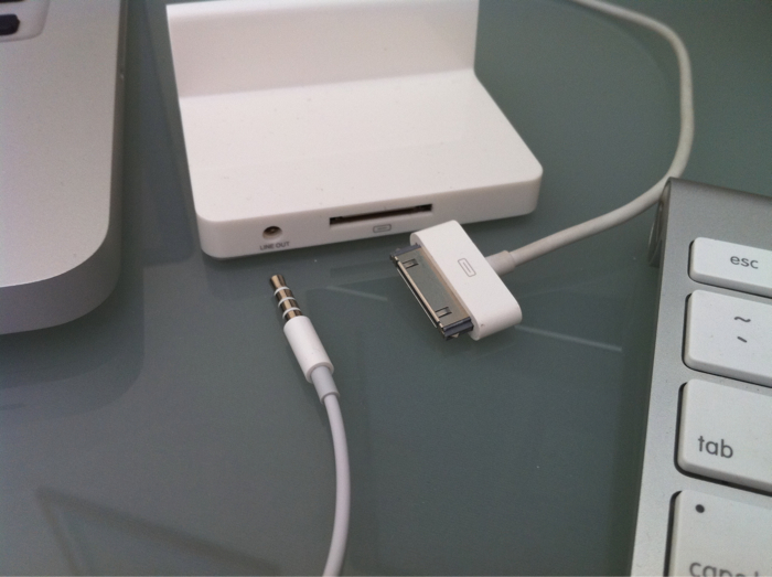

1.Disassemble the unit by removing the soft back side which let us take a flat screwdriver to lift and remove the bottom plastic part.
2. remove the 30 pin connector unit and trim the 3mm plastic that the connector sits on.
3. get a good 3 sec adhesive and apply on the 30 pin connector bracket, hold it until it firms. i also used a glue gun in order to fill the unit from the
inside so the connector wont get wobbly.
That's it!
Enjoy your new modified dock.
