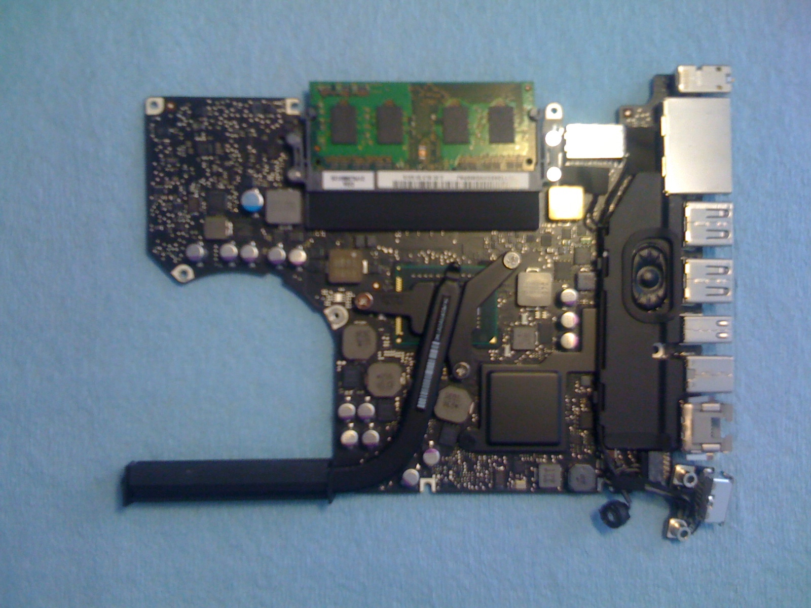

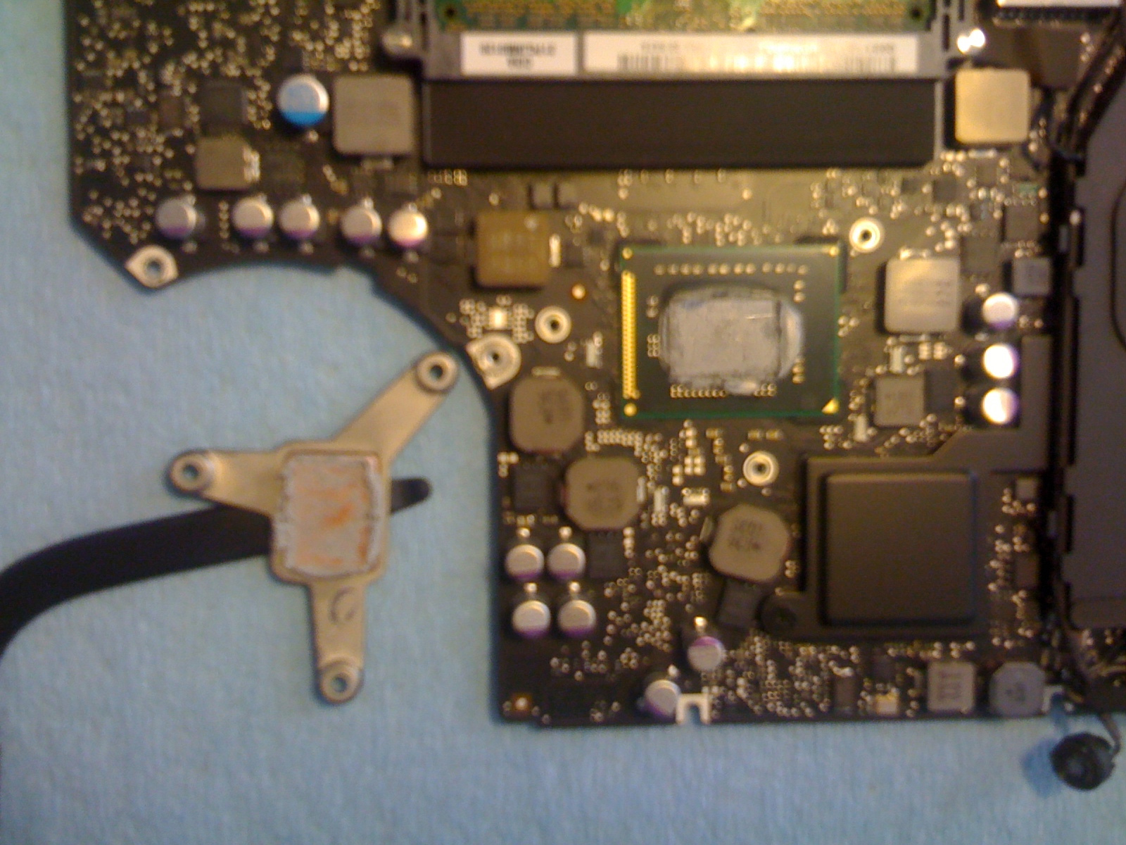

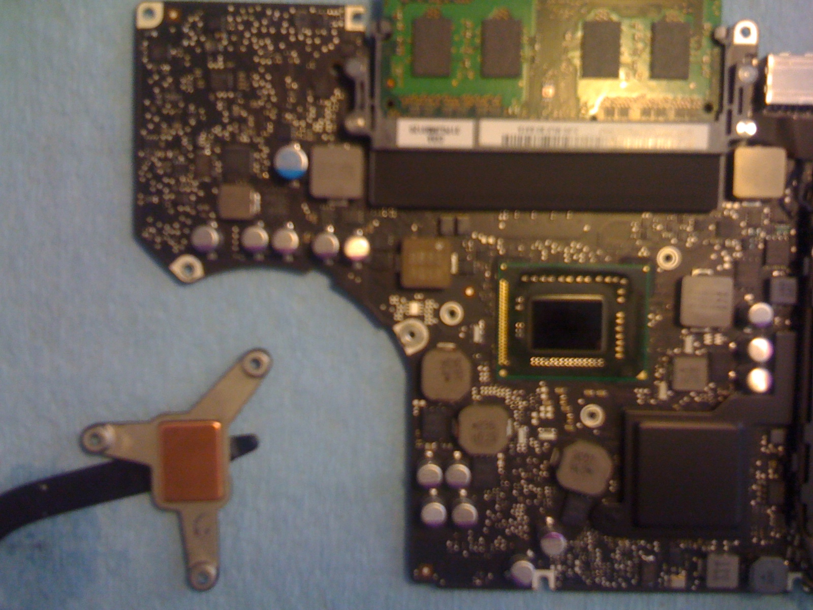

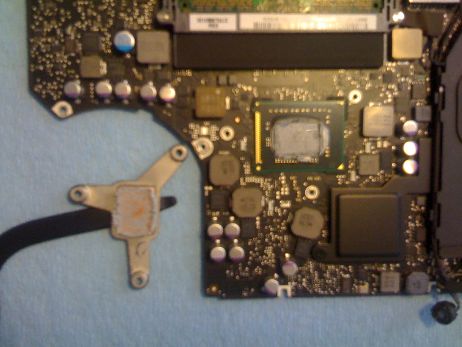

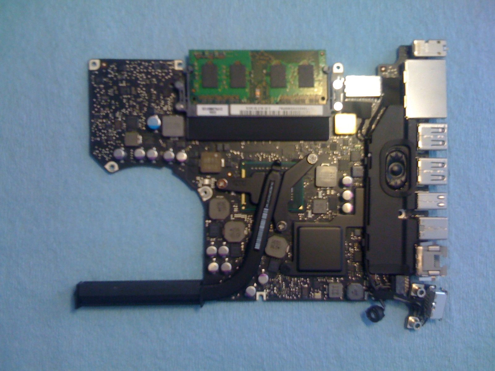

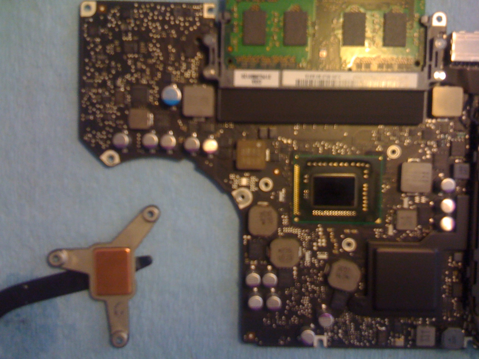

Some pics of the dismantled Macbook before I reapplied thermal paste:
Note: I did not need a Tri wing screw driver to remove the battery, I just unplugged it and managed to remove the logic board with it in place. I followed the ifixit guide online, and was nervous with all the delicate wiring, but after the second try it became very easy. You just have to know how to remove them and your fine.
I reapplied thermal paste almost 4 times before I got the best results I think I could get. Applying as thin coat as possible (with a cut up business card) and being careful on tightening the heatsink makes a big difference. I used arctic MX4 thermal paste, but brand won't make much difference.
