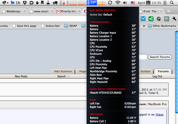

I bought it in January 2009. 15" 2.53Ghz, model A1286 with the removable battery cover on the bottom.
Used to be my MBP's fans would only kick in when something really CPU intensive was going on or if I had it in bed with me resting on sheets, creating suboptimal thermal dissipation conditions.
See the first screenshot for what it's usually like now.

Lastly, do you agree that I should try this? As I type this, my MBP's temperatures have stayed basically the same and the CPU is barely being used. All I'm doing is creating this post!

Hmmm. Resetting the SMC seems to have done *something*. The fans now idle at around 2,000 RPM. I'm in a slightly noisy computer room now and cannot hear my MBP's fans anymore. Before, they were very audible, blasting at full force.

Also.. what's a normal operating temperature for my Core 2 Duo CPU? The fans are quiet now, I'm typing this post and am coding something in C++ in Xcode. Can't hear the fans. CPU temp is at 72 C.

Seems the issue went away for a few days but now it's back. I just spent the past 40+ minutes doing nothing but reading Osama related articles on nytimes.com and yet the fans are spinning at close to 6,000 RPM and the CPU temp is at 74°C. It's pretty annoying.
Since I've reset the SMC, already, what would be the next step to try here?
