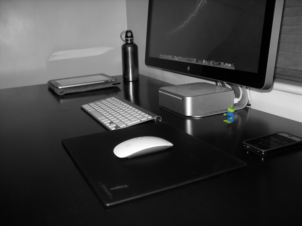

The Old gen mini fits nicely on the stand of the ACD looks nice there.
*That pic is of my older 24in acd, but you get the idea.
