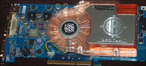

G5 Dual 2.0 GHz AGP can run these cards...
Flashed Nvidia 7800

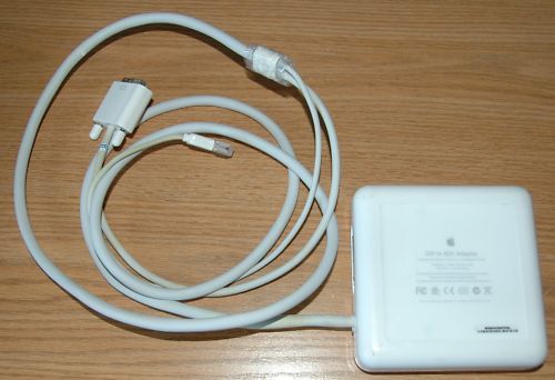

As for the ADC monitor and connections, if you had an ADC and you wanted to hook up a second DVI monitor, you will need one of these...
ADC to DVI Connector
Or connect an ADC monitor to an existing DVI connection, you will need a DVI to ADC conversion box
