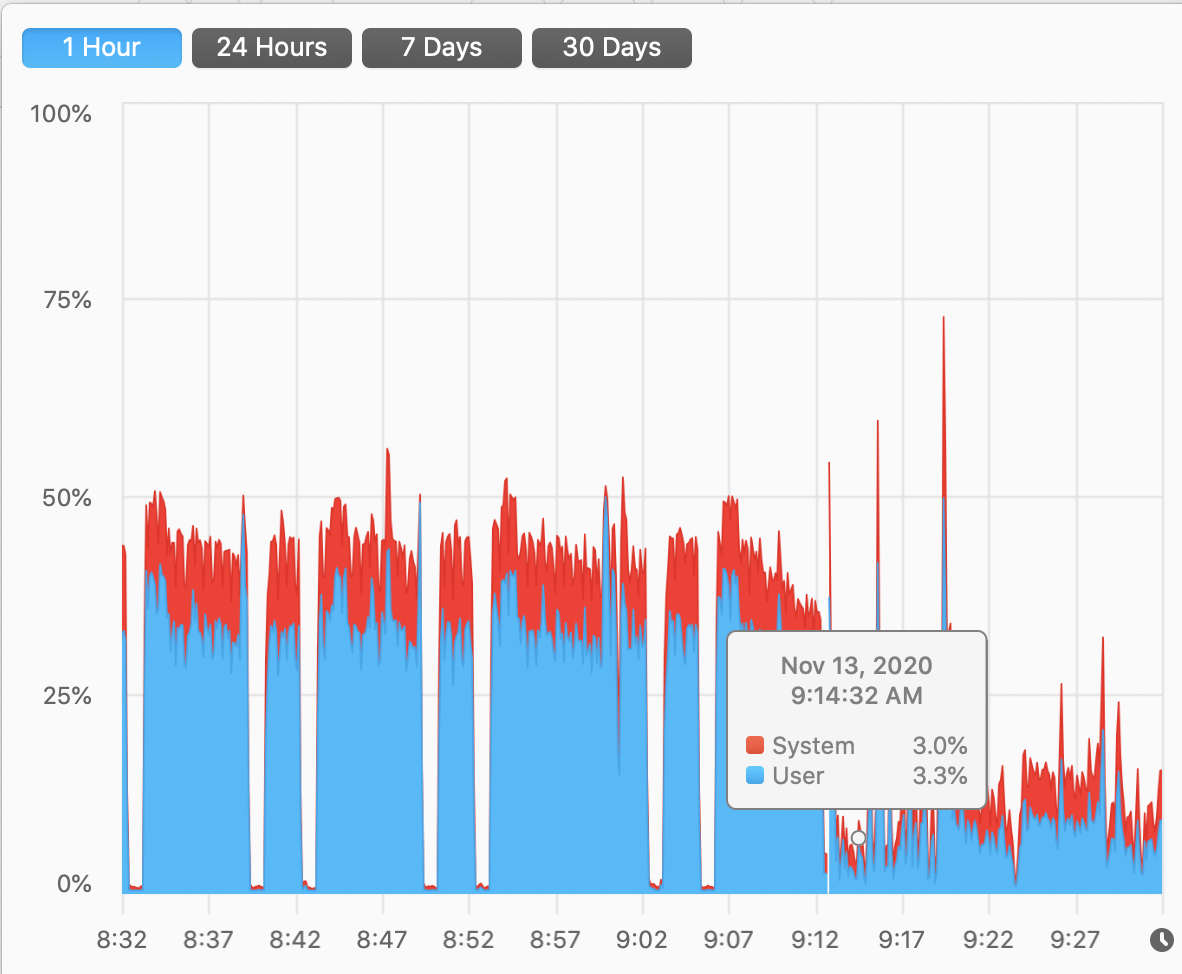

I also have a 2020 MBP. I also leave it plugged in overnight, lid closed, but I use AlDente to limit the charge to 78%. Some mornings it's stone-cold, some mornings it's warm. I too would like to know what's going on while sleeping to make it so warm. Notice the drop in CPU% after I opened the lid around 9:20 A.M.
