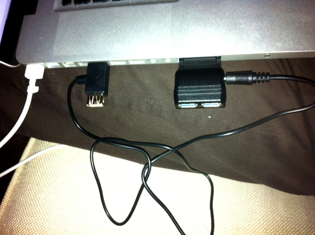

On the website the card looks nice and simple, in reality it is an express card but it has a extra hole for power, a weird USB extender with a power cord coming out of it's side (blocking the USB port next to it, or when used on the last USB port, blocking the thunderbolt). the power cord plugs into the side of the connector block that sticks out.
How can I describe this? Typical windows looking solution? The power cable is almost 3ft so it makes for a lot of clutter.
attachment.php

The Conceptronics box comes with it's own USB3.0 mini connector and splits into TWO USB plugs, one for data, the other for power. Much more elegant solution then the weird Caldigit one.

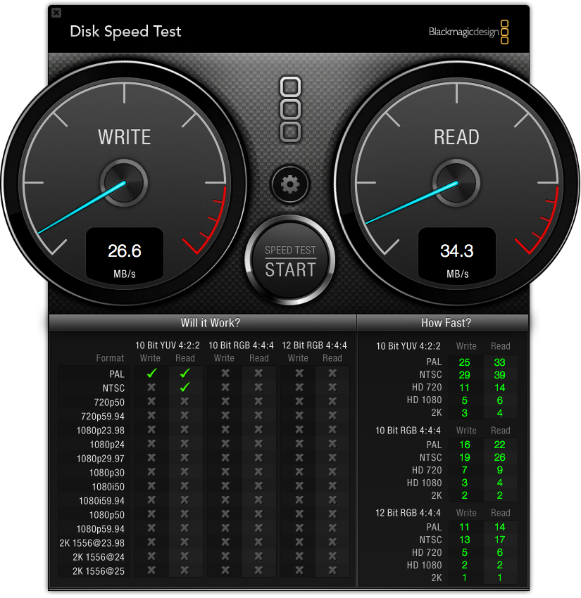

Just to see the difference between the build in USB and if the Caldigit actually delivered, I connected the SSD to the build in USB ports, this was the result:
attachment.php
26.6 write, 34.4 read speed. not bad but the build in drive already got me up to 60mbs.

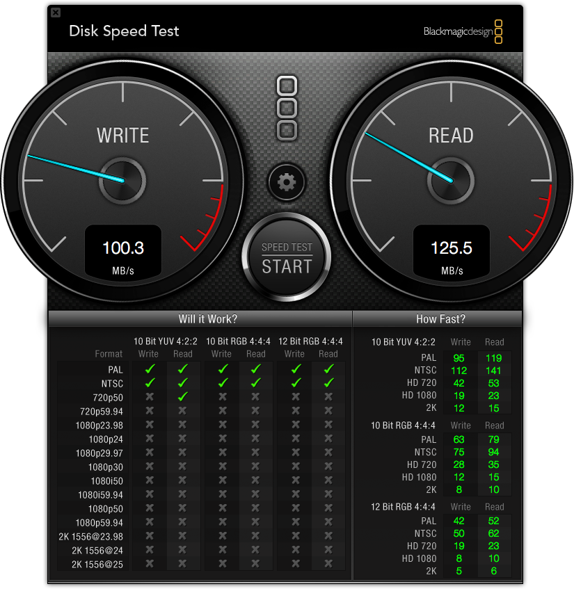

Here is the first result of the USB 3.0 connection:
attachment.php
100.3 write and 125.5 read. Pretty good but I figured perhaps with a reboot maybe the drive would initialise better when the card is already inside the machine?.

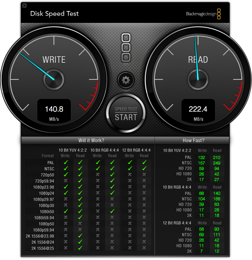

So did a reboot with the Caldigit inside the press slot and got this:
attachment.php
140.8 write and 222.4 read.

1: the press card has a terrible lock, it doesn't really "lock" so if you are not careful and unplug an USB from one of the two USB 3.0 ports, chances are you will pull the card out of the mac. Even if you put it on the couch and move it around the weight of the cables can just pull the card out. Giving you a big crash and black screen + forced reboot.
Sucks, I found the Caldigit card has a smooth back, compared to press memory cards I use (SxS cards from Sony or a Wintec.. but this is another story) those cards have a straight piece of plastic at the end of the card and I expect this is where the card get's locked into place.

A reboot might help improve the speed but also connecting the extra power USB plug makes a huge difference. Without extra power the SSD sticks around 120MBS read, while with the extra power it shoots up to around 225/240MBS read.
