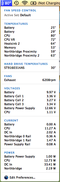

I just took a look to istats, can somebody comment on the infos on the Watt outlet from the charger?
Perhaps you can see more issues there?
It doesn't show the number of cycles or the battery health, but what are you running that's burning up your CPU and running your fan so high?
I am running a Skype video call at the moment, thats why its to "hot" and "fan is on" .. not the newest macbook i got here ;-)
But the charger power voltage, doesn't tell anything about my issue? Isn't it too low?

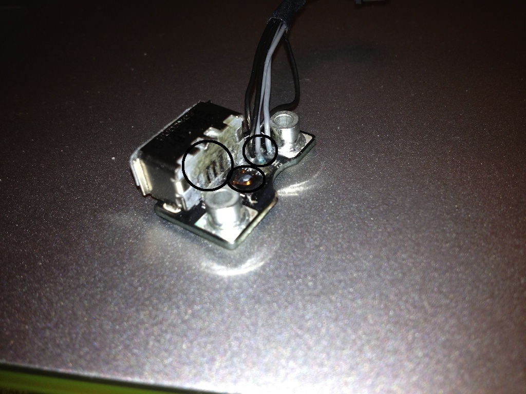

yup,
if you have tested the adapter and battery,
your dc magsafe connector needs to be replaced , dim light is a short on the primary on the magsafe connector board itself, this happens to prevent damage from dirty power into the logic board.
its around 25$ on ebay.
don't try to ignore it and try to fix it somehow else, replace it or you could face a logic board replacement,
i have ran into this 20+ times, mostly liquid spills.
ill upload a picture in a few and show you what and why this happens.
If you look at the picture, you can see this board is bad by the burn streaks in it and the input coil is burned up.
you can visually inspect it, it may look fine but you can test the grey and black lines coming off this board with a multimeter to see if its bad.
the board can be damaged by liquid , dirt(metal) conduction on the magsafe dimples on the connector, short in laptop or just static (unlikely)
the board can be replaced in 15 minutes by anyone who knows how a screwdriver works.

@MacModMachine, thanks for the detailed info, i think i will just get that New DC Board and will put it in myself.

Attached a screenshot of my istat's, if it helps.
