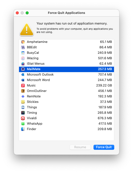

I think I have a pretty bad case over here. M1 Max with 64GB of RAM. Look at Apple Music, this is ridiculous.
Logging out seems like the least painful solution.

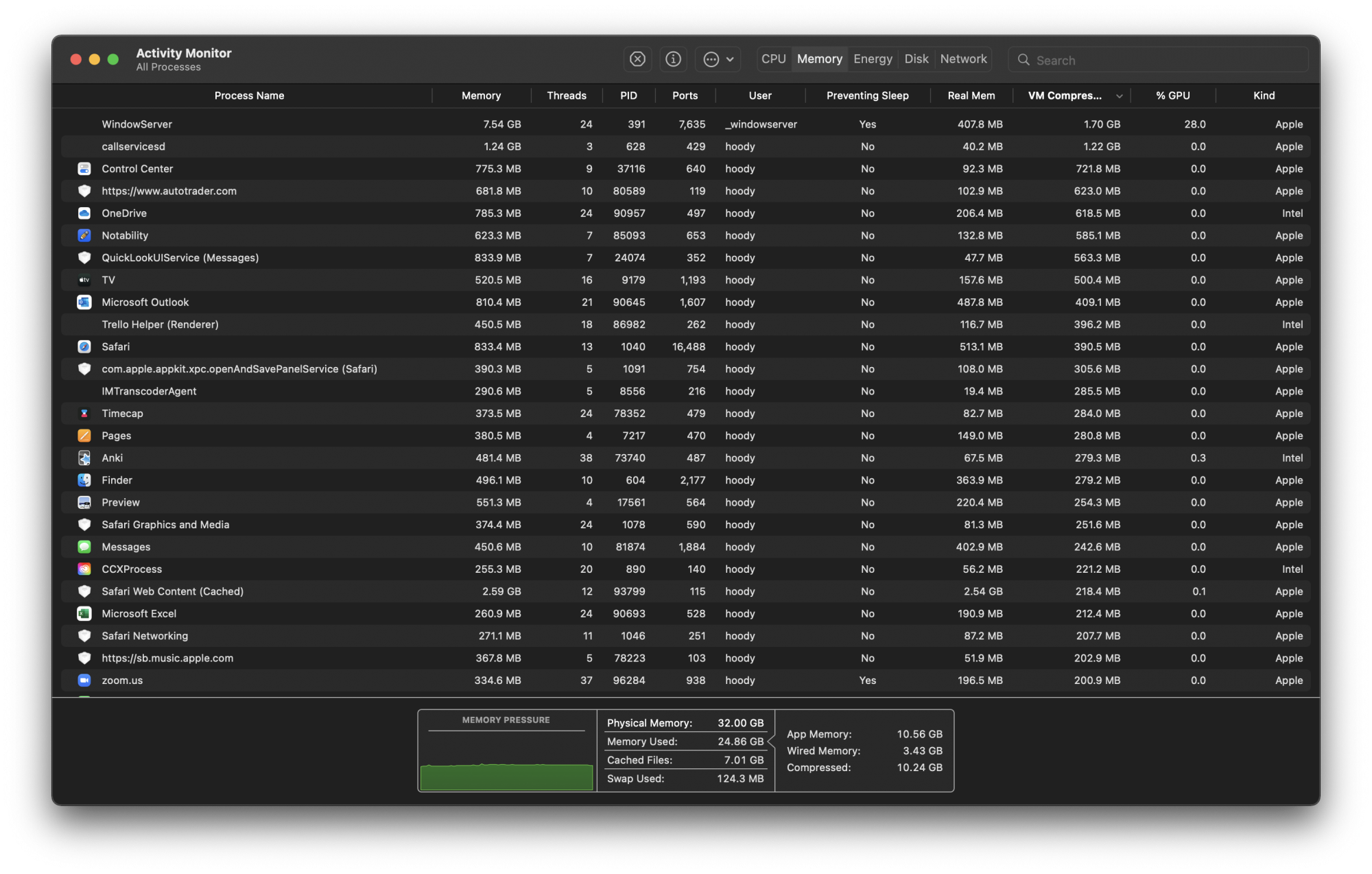

I’m also seeing high memory usage here - unless WindowServer really does need 7+ GB of RAM?
No slowdowns, though, even when using Photoshop ’22 + multiple Excel files + InDesign ’22… Machine is amazing!

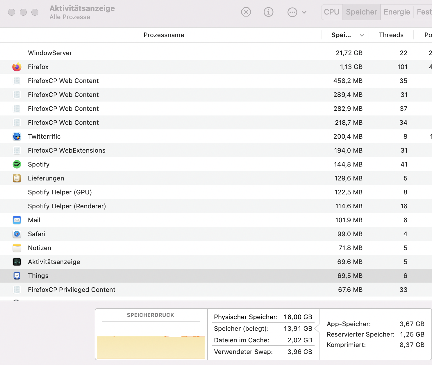

Just force quit it in Activity Monitor. Your screen will go black for about 3-5 sec and then your login window will show up and you are back in business.
