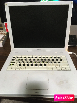

Hey guys
I picked up a 133Ghz 14 inch Ibook off Ebay and when I plugged it in NOTHING.. No startup chime no screen nothing. Any ideas what may be wrong?
Thanks
Gary

hey guys
when I plug the adapter in it initially shows a green light then turns amber for a few moments then goes back to green. Then a few moments later goes amber again!
Gary
[automerge]1572094767[/automerge]
I tried removing the airport card and the memory still nothing. removing the battery the adapter light stays green but still nothing from the computer. It was a parts machine on ebay the listing said they didn't have a power cord so they couldn't test it. I hoped all I had to do was plug it in but Oh well. only cost $30
Gary
