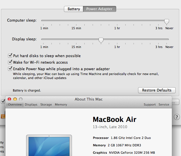

Yes, it's possible! You'll need to update your SMC Firmware using the following packages.
(Edit: links removed. These packages are no longer needed as Power Nap support has been officially added in the Mac OS X 10.8.2 update)
After installation, the Power Nap settings will appear in the Energy Saver preferences pane.
Disclaimer: Install at your own risk! These updates were pushed out during the Mountain Lion beta, but for whatever reason Apple has not yet made them generally available via software update. It's possible that issues were discovered with the updates during the ML beta, or maybe they just decided at the last minute not to release the update for older Macs.
Warning: These files are for the MacBook Air (Late 2010) only. Do not attempt to install them on other models!

Update: It does work. Power Nap activates hourly, so your MacBook has to be asleep for at least an hour for it to do anything. See my post below.

Folks, it does work!
To validate, I left my 2010 MBA asleep overnight, but plugged in to power connector.
Upon unsleeping in the morning:
  • Mail was already updated with all my messages that came in overnight.
  • iMovie software update that I had not downloaded yesterday was downloaded (though not installed)
  • System console has lots of messages timestamped during the middle of the night, while it was asleep
Looking at the console log, it appears to have woken itself up approx. every hour, done its thing, then gone back into full sleep a minute or two later:

27/07/2012 05:55:30.000 kernel[0]: wlEvent: en0 en0 Link UP virtIf = 0
27/07/2012 05:55:30.000 kernel[0]: AirPort: Link Up on en0
27/07/2012 05:55:30.000 kernel[0]: en0: BSSID changed to 00:1f:f3:06:3f:f9
27/07/2012 05:55:30.000 kernel[0]: en0::IO80211Interface::postMessage bssid changed
27/07/2012 05:55:31.000 kernel[0]: AirPort: RSN handshake complete on en0
27/07/2012 05:55:31.014 configd[18]: network changed: v4(en0+:10.0.100.7) DNS+ Proxy+ SMB+
27/07/2012 05:55:31.037 UserEventAgent[11]: Captive: en0: Not probing 'MyNetwork' (protected network)
27/07/2012 05:55:31.042 configd[18]: network changed: v4(en0!:10.0.100.7) DNS Proxy SMB
27/07/2012 05:55:31.390 airportd[2044]: _doAutoJoin: Already associated to “MyNetwork”. Bailing on auto-join.
27/07/2012 05:55:37.030 netbiosd[45]: name servers down?
27/07/2012 05:57:36.000 kernel[0]: AirPort_Brcm43xx::powerChange: System Sleep
27/07/2012 06:57:34.000 kernel[0]: Wake reason: RTC (Alarm)
It is working for me. See above.
Hey Reason - can you let me know what command did you run to get those logs?
It seems to work for me too, as everything was up to date when I came from work, including the TM backup!
That's from the System Log in the Console app:
/Applications/Utilities/Console.app
Mine is a 13".
You could try resetting the SMC (I did this on a whim yesterday):
http://support.apple.com/kb/HT3964?viewlocale=en_US&locale=en_US
I also clicked "Restore Defaults" in Energy Saver, and have Power Nap enabled in both Battery and Power Adapter (I tested with the Power Adapter connected).
I tried resetting both of these. Gonna do some testing to see if it is working now. Hardest thing is waiting a whole hour for it to actually work! haha :)
Way too anxious. I would LOVE this feature. :D
Hmm. Looks like it is working to an extent on my machine. I get the same kernel wake logs, and thigns do seem to be showing up. I think the real test is to let it sleep for a few hours, let the notifications rack up, and then unplug your router/open your computer. If it is *really* working, they should be there. If not, then it isn't working. Will try once I get home.
Also, can't get find my mac working while it is closed... Odd.
Edit: Seems like find my mac is working when it is closed! I was using beta.icloud.com, and it refused to find it - saying it was offline. But when I use icloud.com, it seems to find it right away.
This is so cool! :D
