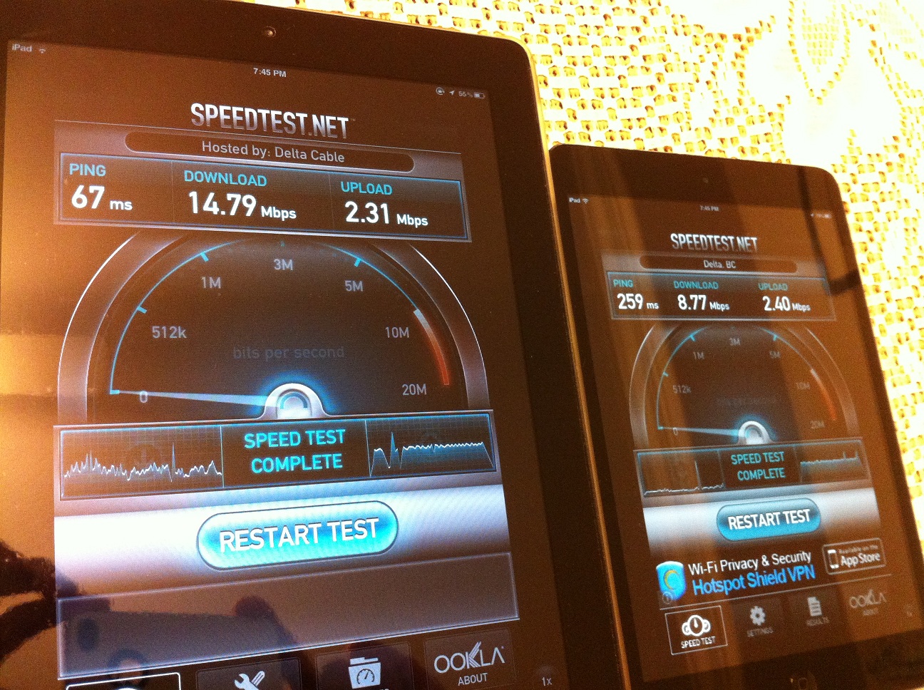

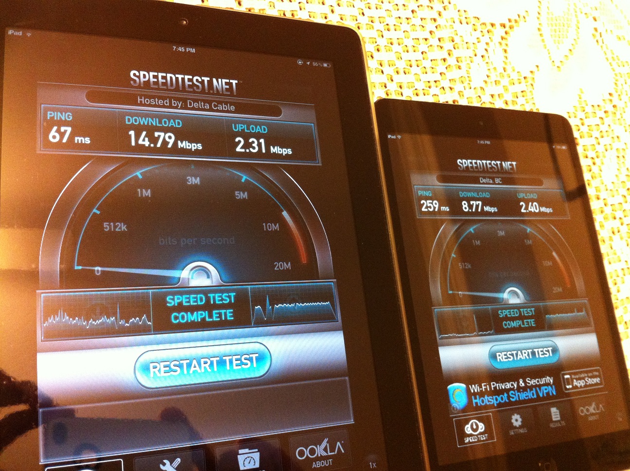

Just got my iPad Mini today. I have the same issue! WiFi performance has been very inconsistent on the iPad Mini. I was watching videos on youtube and noticed the videos were either loading very slow or not loading at all... I immediately did a bunch of speed tests on the same spot for iPhone 4, iPad 2 and iPad Mini and saw a big difference in WiFi performance.
iPad 2 consistently scores ~ 15Mbps
iPhone 4 consistently scores ~ 12Mbps
iPad Mini running iOS 6.0.1 scores~ 3 - 9 Mbps
Did Apple decide to slap on a cheaper/inferior WiFi radio chip on the iPad Minis? Or did I pick up one from a bad batch?
Did a little bit more testing, I noticed the WiFi performance is a lot worse on the iPad Mini when holding it in comparison to leaving it on the table. Perhaps it's the case of design issue again similar to the initial batch of iPhone 4?

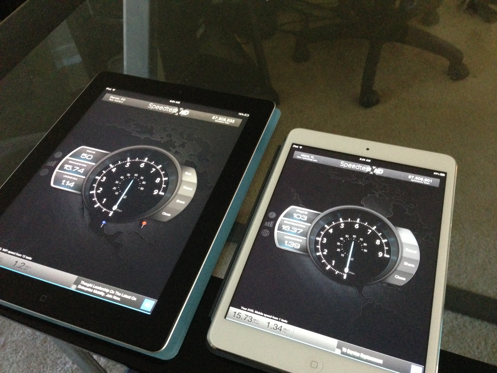

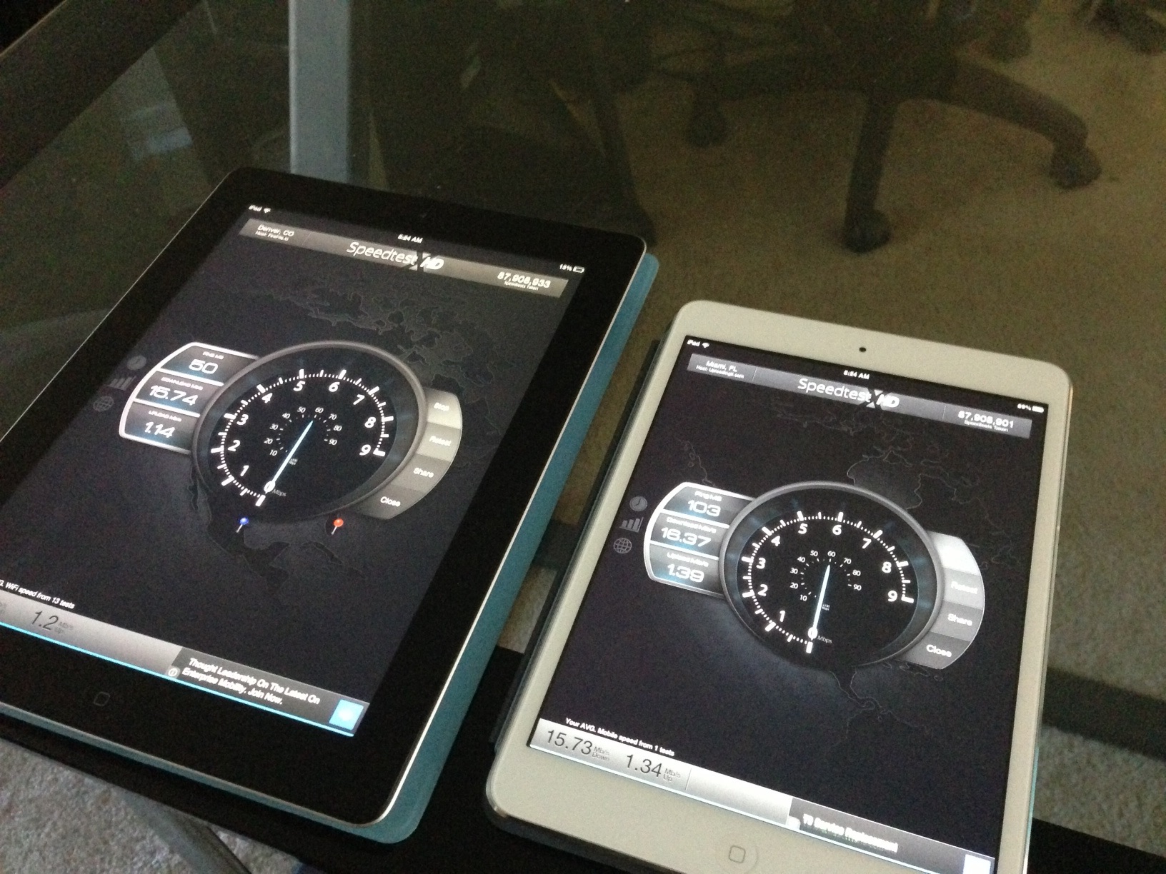

No issues here on my mini. They are always within about 1 Mbps of each other.
