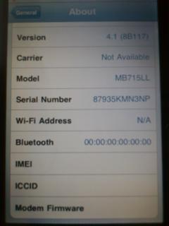

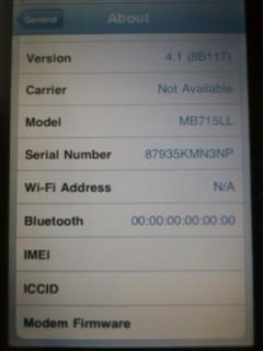

secretanchitman/dextr3k,
I have attached by friend's iphone 3G Settings->General->About screenshot. Managed a quick snap before it entered it reboot loop :mad:
Phone pops up a "Restore Needed" message before rebooting.
Only today I got a custom ipsw loaded onto the phone by some local iphone jailbreak experts.
But you can see that they couldn't restore the baseband and asserted that it CAN NOT be either.
Your posts are encouraging and restores belief that it may be possible to restore the baseband.:D

Give us the first 5 digits of your serial number.
You might have tried to install the ipad bb on an incompatible 3GS and caused irreversible and permanent damage.
Right now its on the process of jailbreaking and downgrading to ipad baseband. I just restored it to 4.1. Ill reply as soon as i get the inforamtion. Thanks much!
Got it sir. its 87137
Hope that i can still fix this. Thank you!
I got bad news Athena.
That iphone 3GS is not compatible with the ipad baseband.
Anything higher than serial number xx134 has the new fixed bootrom.
In other words you pretty much fried the baseband,wifi, bluetooth and the rest communication chips when you installed the ipad baseband:(
Nothing you can do to undo that now besides getting a new logic board.
