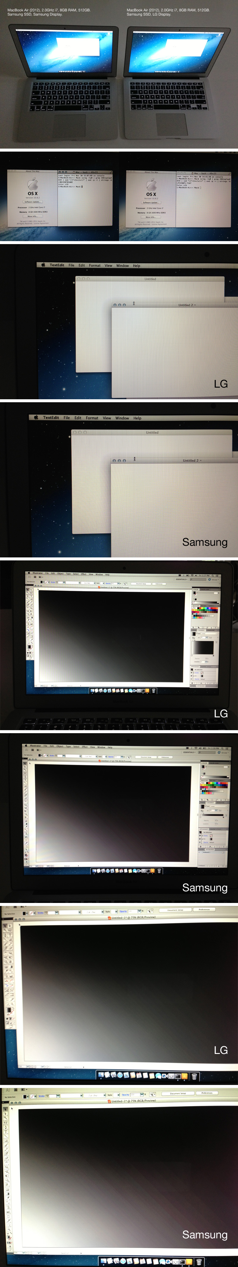

It was now time to power up both units and do some some real-world side by side comparisons to work out if the Samsung display really was as good as it seemed.
I powered on my LG and instantly noticed that it was a little brighter than the Samsung. I was right, the greys of the Mac OS X interface looked much better on the LG. Totally neutral with no red tint. I also noticed that the window drop shadows looked less pronounced on the LG - possibly due to the greyness of the gradient compared to the slightly warmer Samsung display.
I started thinking about this whole LG 'washed out' thing that's been thrown about at MacRumors. These things are always subjective but to me, I think this comment is a result of the slightly brighter LG display and more accurate greys making the display feel brighter and less saturated. The Samsung display has a touch more contrast resulting in slightly darker blacks but it's also more saturated too. This is probably why most casual users think that the Samsung display is better than the LG.
More contrast and more saturation = better. Right? Maybe not...

At first glance, most would assume that the Samsung is the better display. If you use your MacBook Air for reading, browsing, coding and other non-design related work then the extra contrast and saturation might be perfect for you and probably the best rationale for the Samsung praise here at MacRumors.
However, the the Samsung display has once huge caveat that a lot of people have overlooked in their testing - how it deals with gradients.
Let's get one thing straight before I continue. Both displays aren't great with gradients. There's no such thing as a perfectly smooth non-banded gradient on a non-IPS LED display but the LG is much better at rendering gradients than the Samsung. To put it simply. Gradients look ok on the LG and terrible on the Samsung. For some strange reason the Samsung display cannot render consistently toned gradients.
For years I've always used a pixel and vector based gradient test as the benchmark for display quality. For testing, I used monochromatic gradients from 100% black to 0% (white). I tried linear and radial gradients as well as colored tests too and the results were the same. The LG has a consistent and natural tone to the gradients. Banding is visible but the steps are more natural/even and the tone is consistent throughout.
The Samsung display is really bad. Banding is heavily pronounced and wildly inconsistent producing uneven tones with a variety of red, green and blue banded hues creeping into monochromatic gradients. It's the same for radial gradients.
Of course, the majority of users don't spend their time working with pure gradients so the test is a little extreme - but, for me, a great example of the quality of the display.
This test has real-world implications. For example, set your background to the dark grey solid color and log-out. The log-in screen has a dark vignette (dark surrounding) that highlights the gradient issue. Of course, if you don't have an LG or Samsung display to compare it to, it really doesn't matter but it's clear from my testing that the LG display is much better.

I wanted to add one final observation during my testing. The Samsung display exhibited a subtle horizontal ghosting issue with light and dark areas of the screen. This caused a horizontal (slightly darker) ghosted band to spill out from light windows on darker backgrounds.
In my test I set the desktop background color to Apple's default solid dark grey. I then opened a TextEdit window. I could see a very subtle darker band (the height of the window) spill horizontally left and right of the window to the edge of the display. If I resized the window the ghosting followed.
The LG didn't exhibit this issue at all.
I've uploaded a video of the issue. Video compression artifacts introduce a bit of radial banding but if you look closely you should be able to see what I'm referring to.

Another reason for LG owners to be happy.
